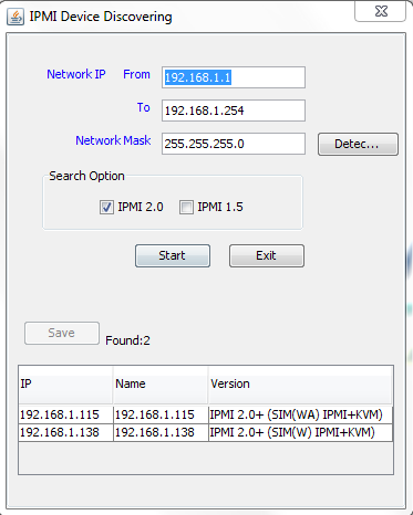

You mention IPMI. How does that compare to technology like Intel’s vPro (specifically AMT)? I’ve got experience with vPro and it was a fascinating technology, but have never heard of IPMI.
We’ve been researching things like that to provide a lights-out server where the nodes are shutdown when not in use, and were going to run with a raspberry pi to provide the VPN access. That TomatoUSB looks amazingly useful.
vPro includes a hardware KVM in a similar fashion, even remote viewing of the BIOS: https://www.youtube.com/watch?v=zaqSMcOBQLQ
There is a pretty comprehensive review at tomshardware and howtogeek had an article a while back.
I just realized the screenshots from the supermicro IPMI screens are the same ones from the halrious videos at http://www.thewebsiteisdown.com/
Do not click ‘Recompute Base Encryption Hash’…
IPMI works great in my experience, you can just click the link in the article to learn more:

(and IPMI aka remote KVM-over-IP works amazingly well, you can reboot and edit the BIOS over the internet.. as long as the server has power, it can be managed using IPMI which is basically a dedicated little ARM computer with its own networking inside the server.)
