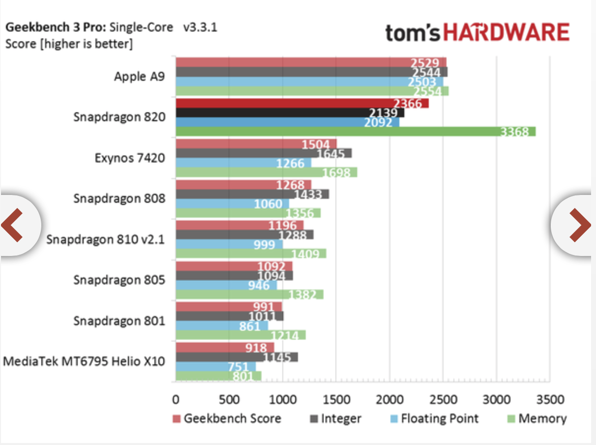

Check out the single core performance of the upcoming Snapdragon 820
Source: Snapdragon 820 Kryo CPU And System Benchmarks
Not quite up with the Apple A9, but a hell of a lot closer than anything we’ve seen so far. Maybe there is hope for Ember/Js frameworks on Android after all.
One would hope. The Anandtech numbers are a little less encouraging when they tested against actual JS benchmarks.
Still, better – Qualcomm basically sucking for the entire year of 2015 did not help matters.
true, but step 1 is getting the single core performance up. There’s still a lot of work to do on the software side but hopefully this starts a trend of Android chip makers keep the single core performance up and trying to get to parody with Apple’s chips. From there there’s still plenty of work to do in V8, but hardware needed to be there too.
Half of the puzzle is getting better, at least. Now it’s Google’s turn.
Let’s hope they get ‘parity’, although ‘parody’ would be sufficient to improve the situation at this point :smile:

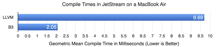

Like a good internet citizen, I pass this link along without having made a real attempt to fully read it or understand it:
B3 generates code that is as good as LLVM on the benchmarks we tried, and makes WebKit faster overall by reducing the amount of time spent compiling. We’re happy to have enabled the new B3 compiler in the FTL JIT. Having our own low-level compiler backend gives us an immediate boost on some benchmarks. We hope that in the future it will allow us to better tune our compiler infrastructure for the web.
B3 is not yet complete. We still need to finish porting B3 to ARM64. B3 passes all tests, but we haven’t finished optimizing performance on ARM. Once all platforms that used the FTL switch to B3, we plan to remove LLVM support from the FTL JIT.
5 « J'aime »
