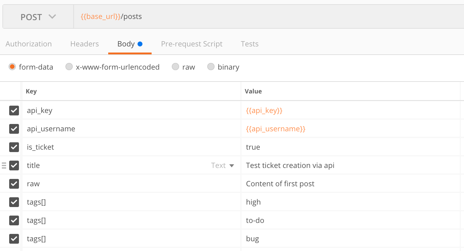

You just need to make a normal API request to create a topic, and add is_ticket=true as a parameter.
Example
Results in:
See: https://discourse.angusmcleod.com.au/t/test-ticket-creation-via-ap/859

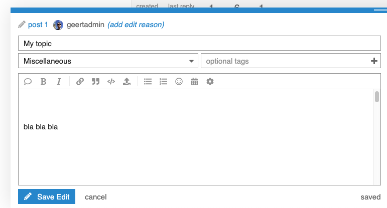

Thanks @angus … apologies for the silly questions but how does one do a “normal API” request like the one in your screenshot? In my “edit topic” I don’t see the Ticket, Priority, Status or Reason? The “Unassign” also seems to be different in my setup?
1 „Gefällt mir“
There’s some great documentation on the API here: https://docs.discourse.org
That screenshot is from Postman which is great for testing out API calls.

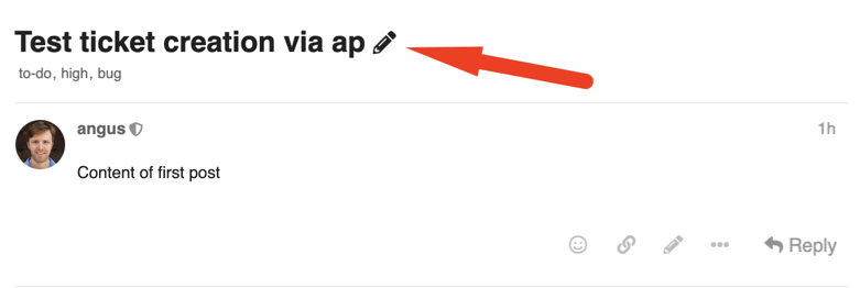

That’s the composer you’ve got there. The Edit Topic UI can be accessed by clicking on the pencil here:
3 „Gefällt mir“
Ok, so below is what my Edit Topic UI looks like. Does it matter if the topic is in wiki mode?

It’s alot of fun! Here’s a screenshot to get you on your way. Note the is_ticket to enable the ticket and that you need a tags[] for each tag you want to add. Also, note that to assign tickets via the API you need to do a follow-up call which I have not figured out how to do via postman.
I also found this useful when learning how to use the API: Reverse engineer the Discourse API

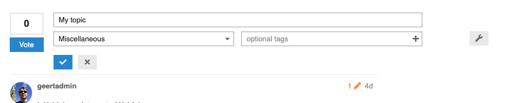

maybe there’s a conflict with another plugin? can you try disabling the voting plugin temporarily and see if you see the TICKET button when editing a topic title?
Disabling the voting plugin made no difference

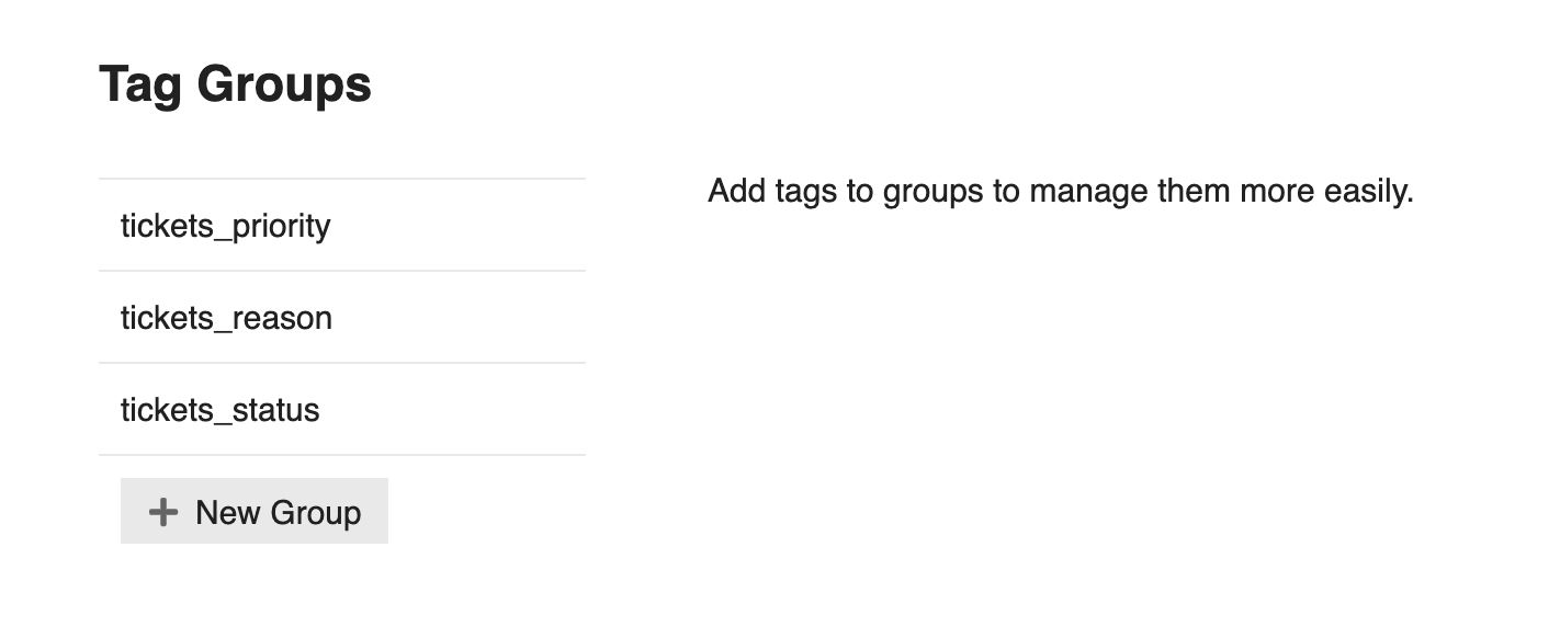

Is it possible you have a typo in the tag group names? Should be tickets_ not ticket_.
Nope, that was just my typo. I did enter a few tags in each group.

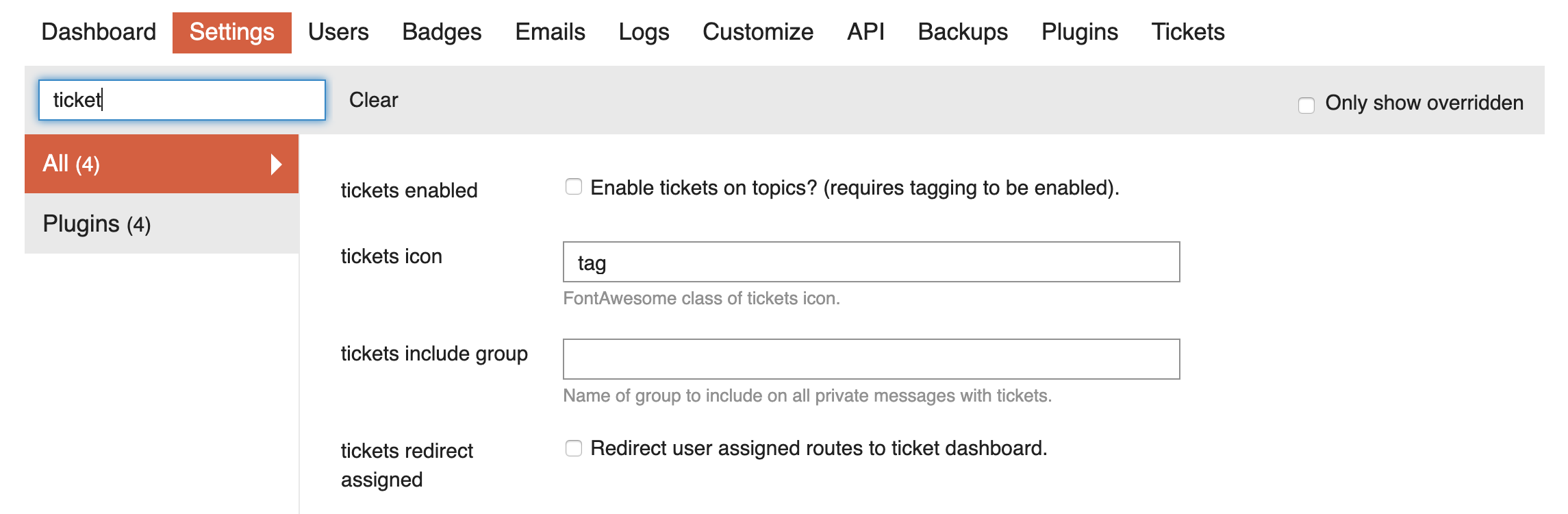

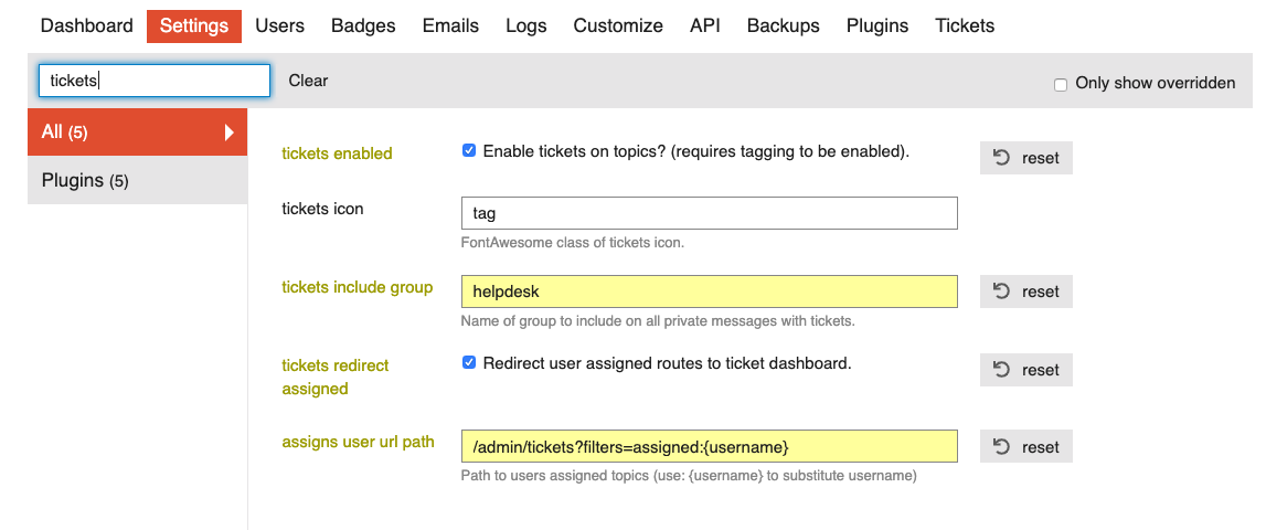

There are three site settings (in addition to the enabled setting)
I’m not sure where these are or if I need to do something.
Here are the plugins I’ve installed:
Well, once you get it working right you will see what we see when editing topic titles. Promise. :sunflower:
Look in ADMIN > SETTINGS and search for “tickets”. Here’s what it looks like for me:
Aside - I’ve just been nudged that it’s time for you and I to get a room. :slight_smile: If this still doesn’t get you on your way and you still need help with getting the ticket button showing up when editing topic title, please PM me.

I thought I’d share my solution for others in the future. I had assumed that the fact that the Tickets Plugin shows up as “Enabled” in Plugins it meant that the tickets plugin is enabled. However, it appears that there is another “Enable tickets on topics?” setting. Maybe an idea to add this to the notes above?
1 „Gefällt mir“
