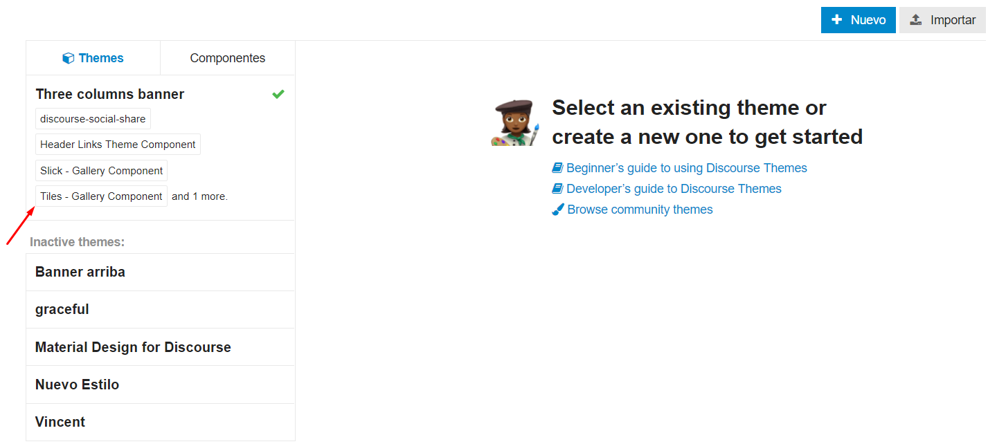

  1. go back to the previous page, then switch from the components tab to the themes tab
  2. select your currently active theme (it’ll have a green check mark)
  3. within the theme settings here there’s a Theme Components section, find your new component from the dropdown and then click “add”
  4. :tada: Now when you return to your forum homepage and refresh, it should be active.

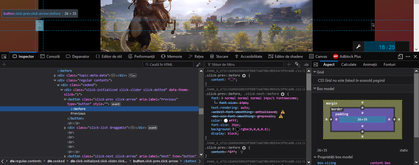

Hi @Johani
A small :bug:
I can’t reproduce this. Those should be arrows (and they’re coming from Discourse core, not the gallery component.) Are you up to date with Discourse core?
4 إعجابات

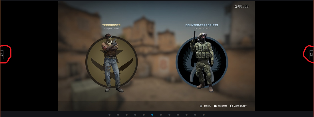

Yes, I use the latest version - v2.2.0.beta8
Check this screenshot:
إعجاب واحد (1)
Ah, well, that’s not the same component, it’s the Slick image gallery component. (And yes, icons are broken for that component. Will work on a fix.)

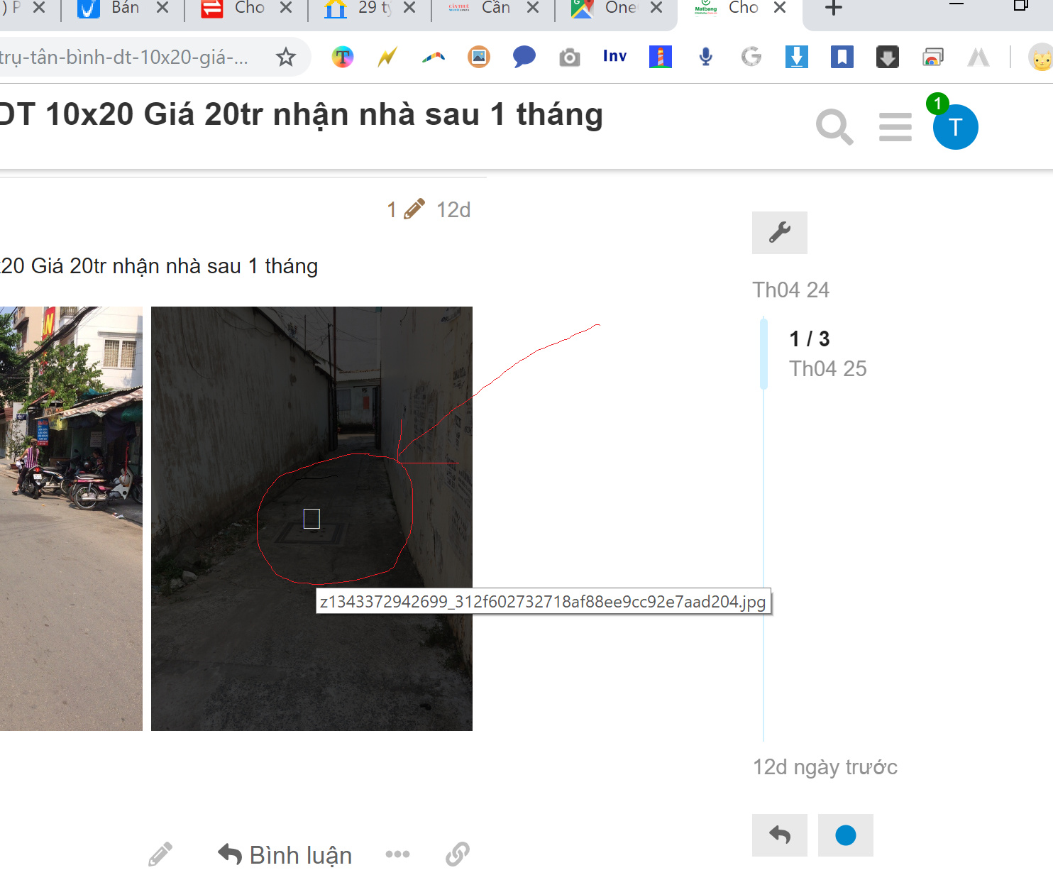

Hello, i have a error about lookup icon when hover mouse into photo
Can everyone have me fix it?
Thank you!
