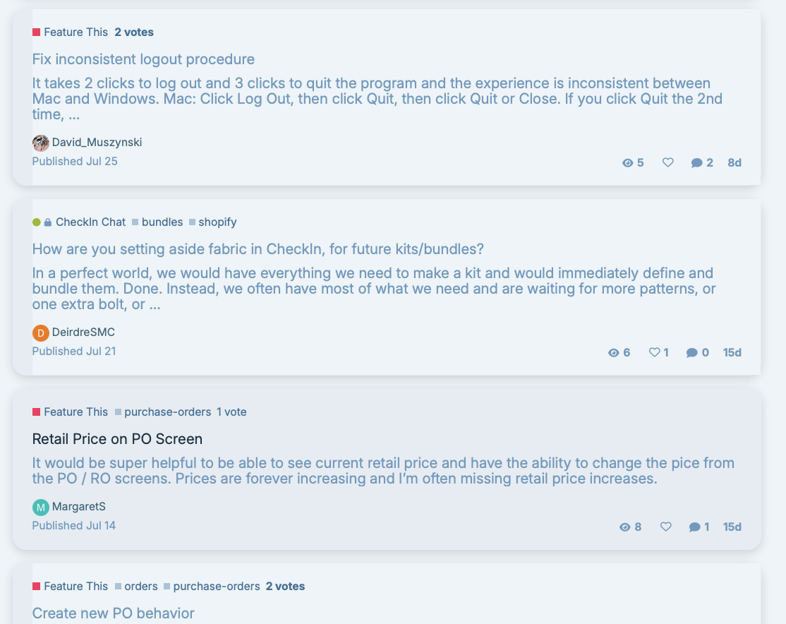

So it appears something has changed with the last round of Discourse updates.
Only the very left edge of my topic cards are now respecting this CSS, I’ve been poking around to try and find what will fix it but so far have been unsuccessful.
Can anyone else confirm and see if they can track down the needed changes?
The problem is the recently added variable for the background color on topics you have read.
I don’t think there is a dev-news about this change. But you can find some information here:
So is there a way to suppress that CSS? This has destroyed the way my site looks and as I’m not really a coder in any sense of the word, I don’t know how to get around it.
I looked through the element inspector, and I see the word ‘visited’ on all the broken topics and I see that it’s missing on the one that still looks right.
How do I fix this?
Topic I have not visited yet (no hover):
And with a mouseover:
And the others are broken.
That was harder to track down than it should have been. (I’m quite sure it’s due to my shortcomings, but still…)
It appears that adding:
.topic-list-item-background-color--visited {
    background: none
Has fixed it without any undesired side effects.
In your styles, you now only need to change these two variables:
--topic-list-item-background-color
--topic-list-item-background-color--visited
So something like this should work:
:root {
--topic-list-item-background-color: YOUR COLOR HERE;
--topic-list-item-background-color--visited: YOUR COLOR HERE;
How would that account for the differences when changing between light and dark?
Also, I don’t want it to be different once visited, and that doesn’t cover the hover color change.
You can use the css function light-dark()
--variable-name: light-dark(#efedea, #223a2c);
You can set them both to the same thing.
Nothing has been done to :hover in core. You’ll just need to make sure to set the variable to what you want when hovering.
This still isn’t working for me.
This is what originally worked:
// Blend topic card colors with theme
@media (prefers-color-scheme: dark) {
    .topic-card.has-max-height {
        background: #223c44 !important;
    .topic-card.has-max-height:hover {
        background: #163d51 !important;
@media (prefers-color-scheme: light) {
        background: #e6ecf2 !important;
        background: #ddecf7 !important;
Then after the latest update I added this is it seemed to work, but then stopped:
    background: none
Then, based on what you said here I tried both adding to the current and replacing everything with this:
:root {
--topic-list-item-background-color: light-dark(#e6ecf2, #223c44);
--topic-list-item-background-color--visited: light-dark(#e6ecf2, #223c44);
--topic-list-item-background-color--hover: light-dark(#ddecf7, #163d51);
There must be another variable that I need to cover hover-visited, because unread threads work right, but visited ones are busted.
This variable does not exist.
--topic-list-item-background-color: ADD COLOR HERE
--topic-list-item-background-color--visited: ADD COLOR HERE
This should be what you need, hope that helps!
This is the least amount of lines I could come up with that seems to be working correctly.
--topic-list-item-background-color--visited: light-dark(none, none);
--topic-list-item-background-color: light-dark(#ddecf7, #163d51);

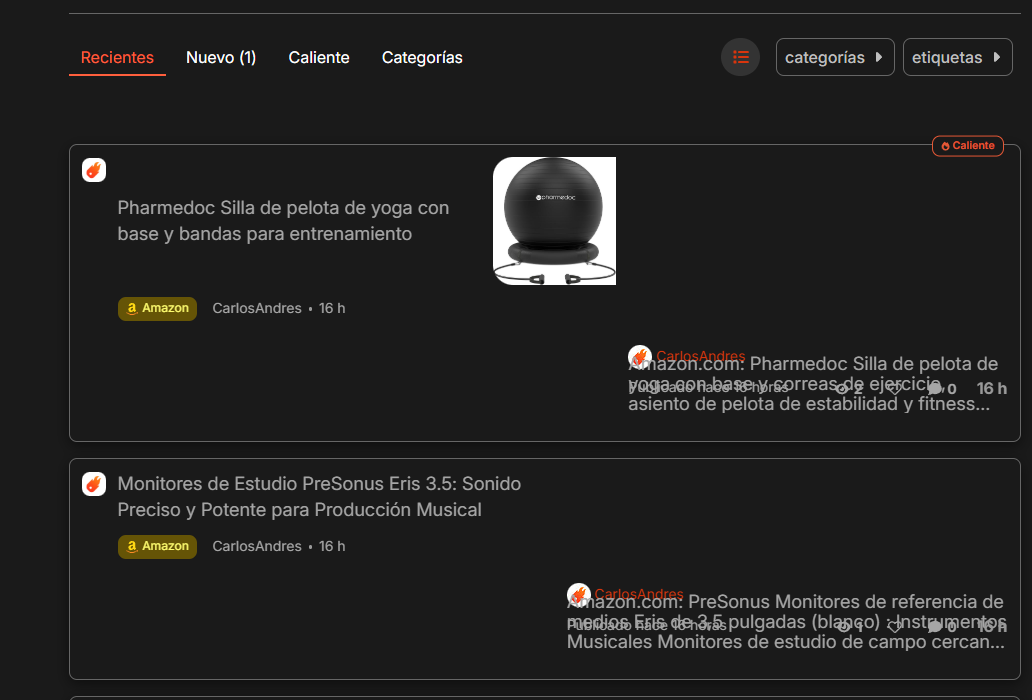

I honestly haven’t been able to make it work, look how ugly it turns out, I use the Horizon theme, help me.
This component is not listed as compatible with the Horizon theme.
I don’t think it will be easy to change that because both customize the topic list, and as stated in the first post:
