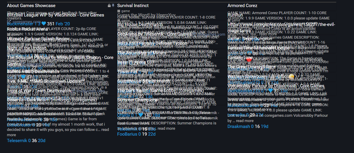

With your Theme Component, I don’t get images at all, looks like this:
Something is breaking your javascript. Have you rebuilt without TLP? Running both will not work.

I have rebuilt after disabling the plugin, yeah. Console only has warnings:
Edit: I did have another component that influences the styling of this page after disabling that I got the images back.
I then rebuilt the HTML of the post from the original problem and now it shows the updated image. So it works with your component but not the original TLP plugin.
