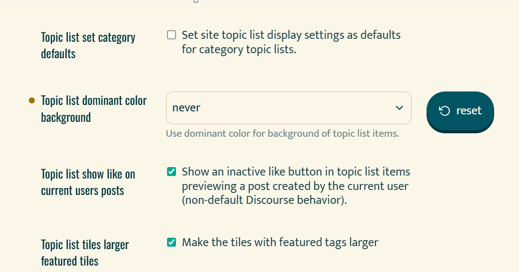

but I have another suggestion. is that possible to remove color grades for list view.
I like it, implemented:
https://github.com/merefield/discourse-tc-topic-list-previews/pull/41
If you think Topic List Previews is awesome & I did a great job, you can buy me a coffee ![]()
- new setting
topic_list_dominant_color_background: default:tiles only, options:never,tiles only,always

Hi, I would like Dominant color background for list view with Thumbnail view, but whereas only list view without thumbnail, I don’t need that Dominant Color background.
can you code it please…
Thank you
Below list view with thumbnail
And this picture below (list view without thumbnail) no need of Color dominant

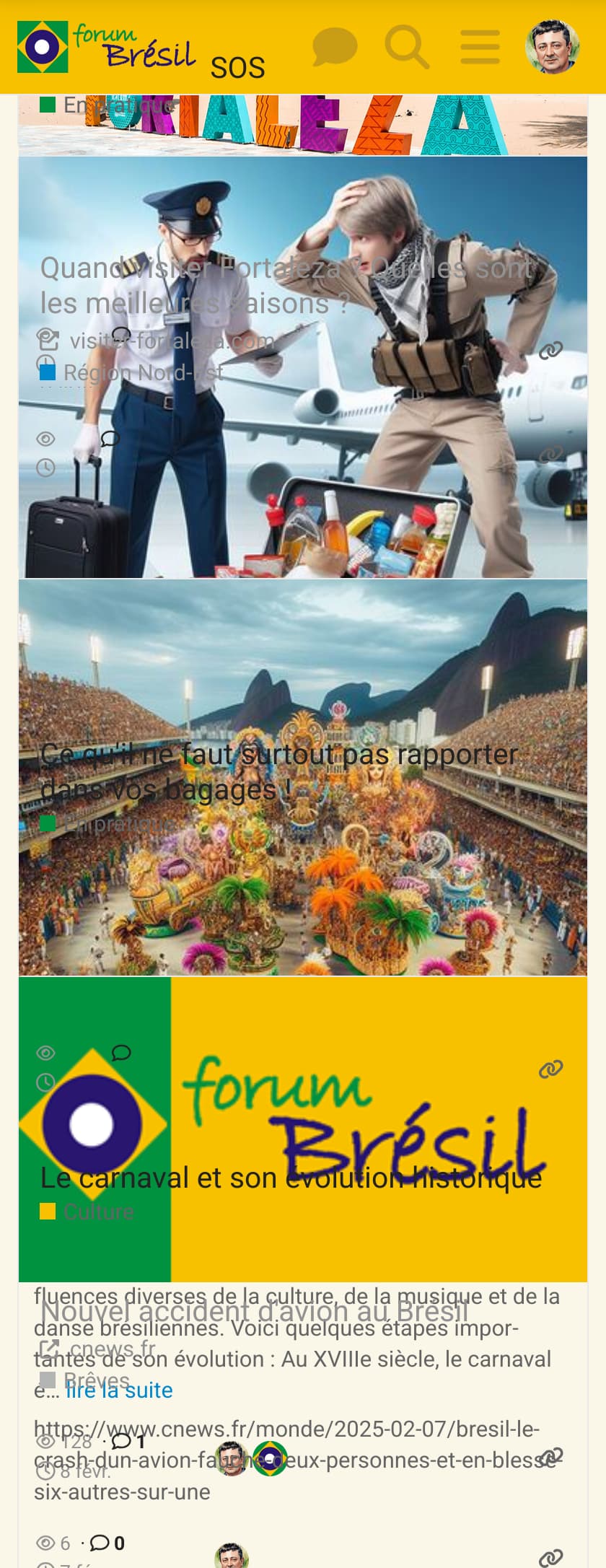

Hi, I have this problem on two of my self hosted Discourse sites (the third one does not show this problem) on my Home page some (not all) topics are mixed with the text of the extract and it looks ugly, the issue is more visible on mobile but shows also on PC:
All my sites are up to date.
I obviously spent time to find out what can cause that, to no avail. (deactivating components)
I remember having this issue long ago but cannot recall what I did at the time to solve it.
If a mixup of thumbnails and excerpts reminds you of issue you had, thanks…
I can’t repro this but I’ve seen that happen once with the new code. I killed the browser and on reopening the site everything was fine and has remained fine.
It’s hard to tell what’s going on on your site without seeing the JavaScript console. Do you see an error in the console when in mobile view on desktop?
Sometimes this can occur when there is a clash with another component or another component throws an error which breaks JavaScript processing in general.

Thanks. Good news (I guess), I am so used to use only Firefox that I did not think about trying on Chrome, and on Chrome, I do not see that issue…
So now why only on Firefox?
I couldn’t find how to open the Firefox browser console on mobile.

No wait I can repro in Firefox on Android, apologies.
Hmmm … not much fun. This could be tricky. I’ll think about what I can do.
Could you try that please:
Firefox does not fully “hydrate” images just offscreen, so this was affecting rendering. I’ve added some additional processing to work around it.
That’s a shame as on Chrome/Edge this isn’t, apparently, necessary.
Great ! Problem solved, that deserves a coffee ! ![]()
