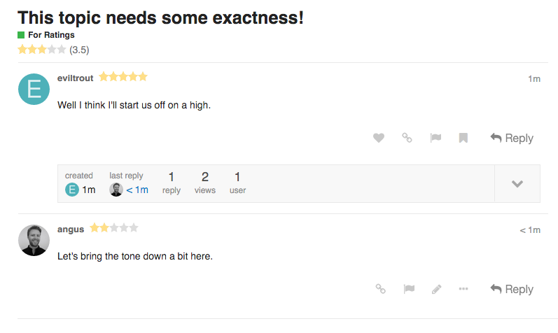

Just added exact topic averages next to topic star ratings, controlled by the Plugins setting Show exact average rating
https://github.com/angusmcleod/discourse-ratings/commit/e2a4fc5e189d445eea4dd6d2257719782dabe401

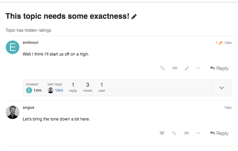

Added a note for admins if a topic has hidden ratings (if category or tags were changed).
https://github.com/angusmcleod/discourse-ratings/commit/25cdf0c3cd24c507c8d56811d9f82add63d6c92a

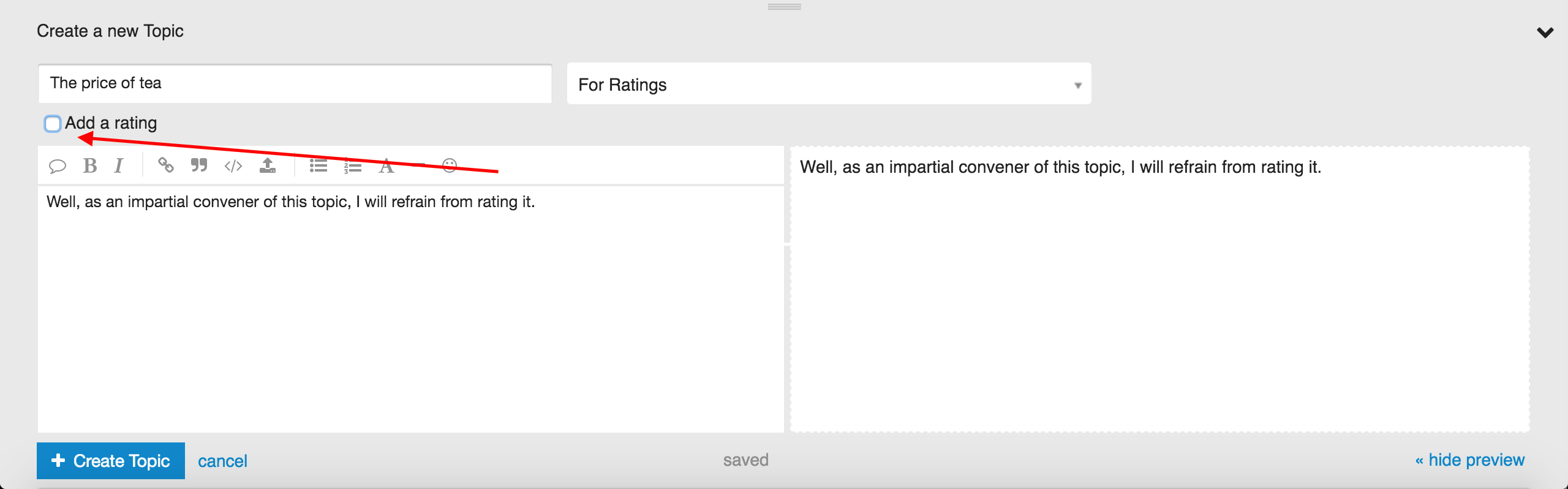

Feature request from github:
My team is building a site called Science Commons where academics can discuss research papers. Each topic is about a single paper; the first post is a “wiki” that contains a summary of the paper. I would like to use your rating plug-in for Science Commons. But my concern is that when I turn on the rating tag, I am forced to give a rating on the first post. Is there a way such that no rating is required for the first post? I want to be an impartial admin who posts the paper and don’t want to give my own opinion about the paper.
I’ve thought of adding this previously and will add this as a setting in a few days time, after finishing the current batch of work on Quick Messages.
I’ve added a feature which covers the use case previously mentioned (i.e. omission of a rating from the first post in a ratings topic), and also lets any user remove a rating entirely from a previous post in a ratings topic. Complete removal of a previous rating allows the user to rate in another post on that topic if they so wish.
