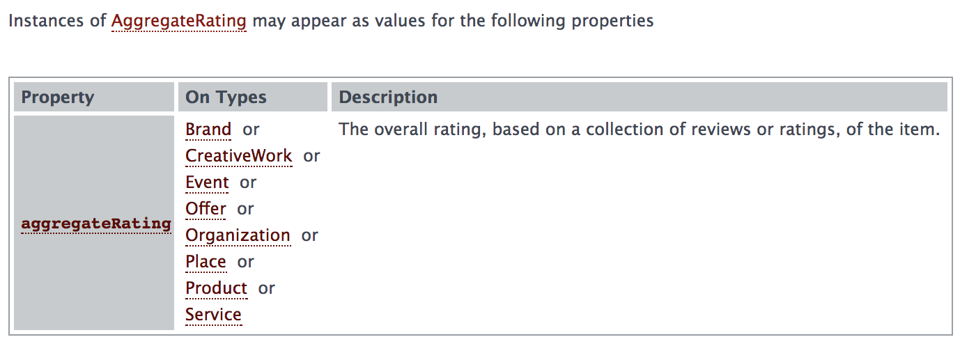

If I understand correctly how schema.org works (which I’m still not sure I do, even after a using it a few times), the schema for AggregateRating will only work if it is within the scope of a ‘type’. It seems these scope types support AggregateRating:
As it (seems) to be type dependent, I’m not sure it makes sense to support it directly in this plugin as that would involve choosing a particular type, e.g. Product or Service. Not all users of this plugin will be using it for one particular type.

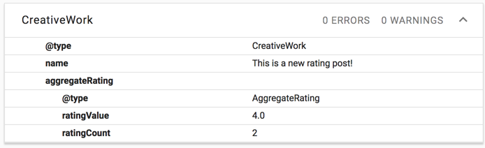

We can add AggregateRating by default. In the allowed schema type list it have CreativeWork. In Discourse we are using DiscussionForumPosting as default schema type. It is a part of CreativeWork (CreativeWork > Article > SocialMediaPosting > DiscussionForumPosting). So it is 100% appropriate to use AggregateRating in topic ratings :+1:.
I manually tested this functionality in Google’s testing tool.

As per @vinothkannans’s advice, I’ve added aggregateRating as part of CreativeWork.
https://github.com/angusmcleod/discourse-ratings/commit/85f82fc2e8843fc8a95847bc82be34eec2b38fc5

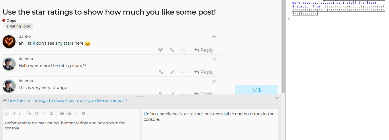

Today I enabled this plugin for the first time on a pretty fresh discourse install and I don’t see the star-rating buttons in a reply box (composer) and I get the following error:
https://github.com/angusmcleod/discourse-ratings/issues/10
Update: after rebuilding the discourse app, I can no longer reproduce the TypeError... but I still don’t see the star-ratings buttons.
Hey :). The addObject exception is actually unrelated to this plugin. It’s a Discourse exception. I’ve been meaning to report it.
As to the ratings buttons not appearing, I can’t repro it unfortunately. Can you send me some screenshots with the console open?

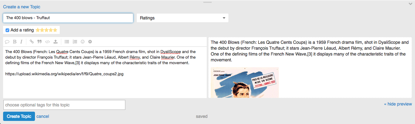

I tested it locally and on my sandbox here: https://discourse.angusmcleod.com.au/c/ratings
Composer:
Topic:
Topic List:
39 PM

On screenshots you can see no errors in the Console and no stars-buttons in the Composer or the average-rating div.
Update:
  1. The plugin works well if the post is created in the rating-enabled category initially. However it doesn’t work for the posts in such directory which have been created/edited before error-less installation of this plugin (i.e. I had some Discourse-related error on the server when initially installed this plugin, but after rebuild there was no error).
  2. Unfortunately the plugin doesn’t appear to be working for the posts initially created in a non-rating category, when those posts have been moved to a rating-enabled category, which is sad :cry:
Thanks for figuring that out. It should work for such ‘pre-existing’ topics now.
https://github.com/angusmcleod/discourse-ratings/commit/2dd9fb80284e9b339f240008a6e8526dd3cb6aac
