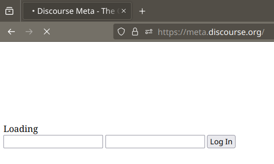

Why do I see this in upper left of the screen instead of the nice login splash screen?
I was able to get access on the plane. Bottom line both issues are caused it is csp. If I comment that policy, it works.

To get a solid brief answer to “Why did this happen?” in here:
Your CSS didn’t load, so you’re seeing an unstyled page.
For example, here’s meta during loading without styles:
Your JS probably also didn’t load… e.g. here’s meta without styles after it finishes loading:
Any time you see something like that, check your network tab to see if your browser was able to load everything or if something failed. That is the problem that needs fixing.
There is a content security policy report only site setting you can enable to let the site work while figuring this out.
