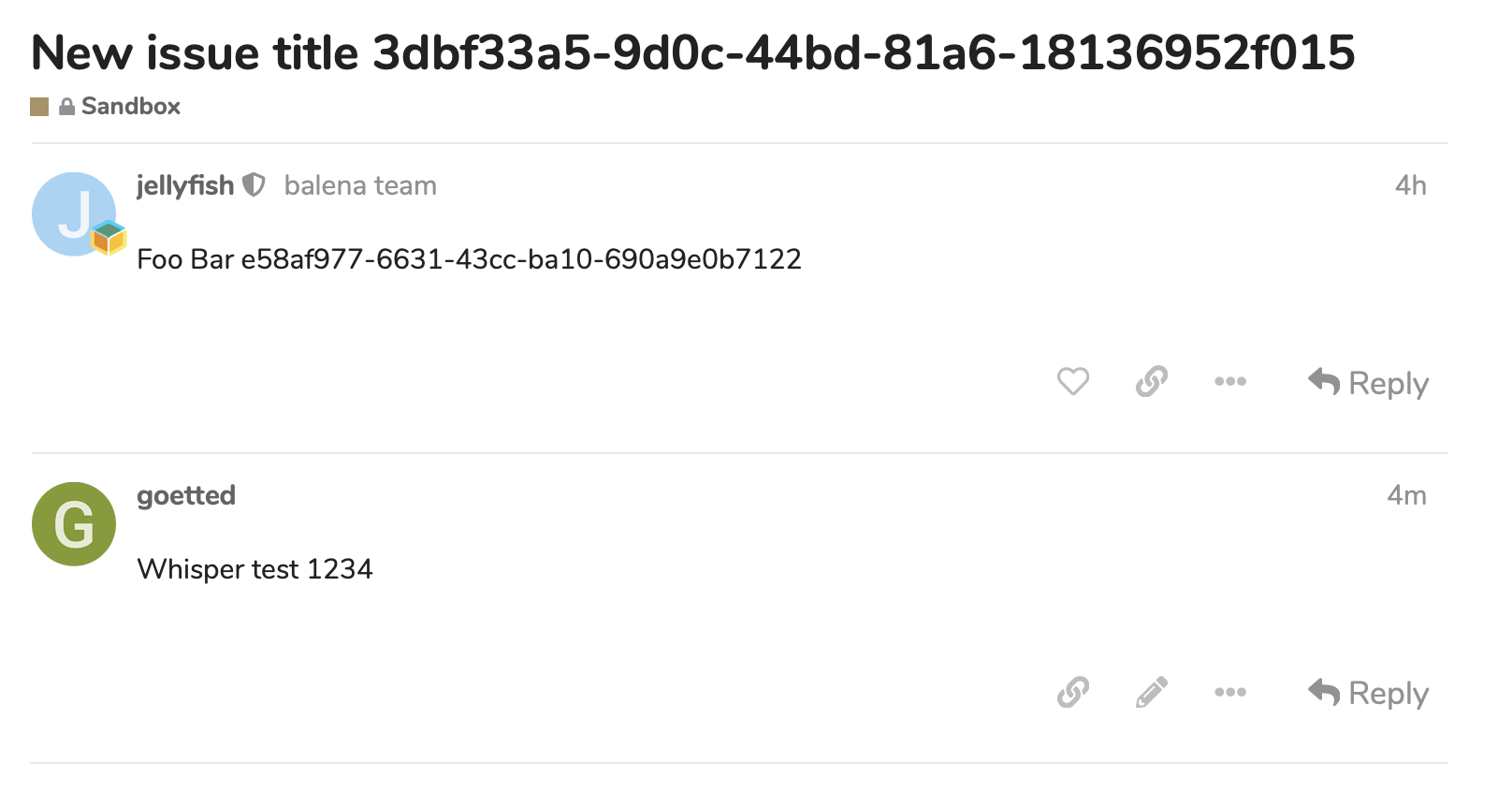

And as you can see from the API response, the message is public:
The message is correctly posted as a whisper if the user has enough privileges.
