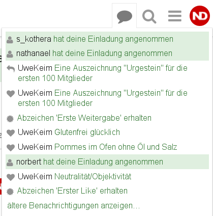

Accepted Invitations still Unread
Even tough I clicked on the notifications, about the accepted Invitations, it is still marked as unread:
I am running: v1.4.0.beta8 +37
I just saw, that when I am on the users page I’ve invited, the unread mark is gone for a moment. But its coming back.
