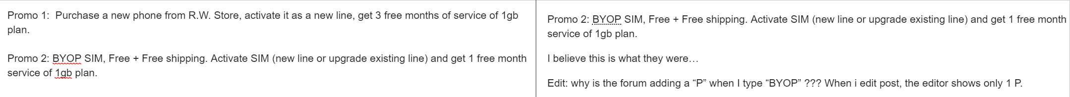

We’re seeing some instances where abbreviations on the Abbrify list are repeating characters. Examples:
and
Any idea what I’ve done to cause that?

Yes, the second example I gave is linked to a user-typed reply, not a onebox. https://forums.republicwireless.com/t/ordering-the-free-sim-cards/18113/12?u=southpaw
4 « J'aime »
Thank you for the link @southpaw
I can definitely reproduce the issue. It’s caused by white-space characters not being removed.
I’ve made a small change in your theme to address the issue until the theme is updated and submitted a PR for @Freso to look at

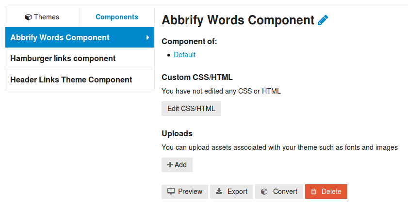

Edit: I have installed it, but I see no obvious place where to define abbreviations.
1 « J'aime »
Which one did you install? Autolinkify or autoabbrify? Can you send a screenshot?
Sure, it was the Abbrify Words component, installed from the Github link above and then added as component to the Default theme of the forum:
Edit: After reading the related lists in Linkify topic, I have the feeling that this does not work as it should. There should be a list here, or not?
Yep, that does not look correct. What is confusing is that it does not even look like a remote theme for m GitHub. :thinking:
Could you try to install the original autolinkify theme and see whether that works?
EDIT: Also, what is your Discourse version? Could you try updating to the latest?
2 « J'aime »
Thank you @danekhollas, my issue was solved with help of the great Discourse team!
