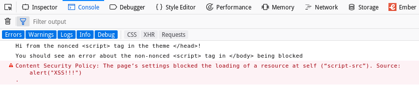

I’ve spun up a temporary instance to show the CSP working in practice: https://discourse-csp-nonce.mozilla.community/
(which gets an A from Mozilla Observatory! Scan results - HTTP Observatory | MDN)
Open the developer console to see the CSP in action:
Just for this proof of concept I’m not adding the nonce attribute to theme’s body_tag to show how this greatly reduces the risk of XSS.
