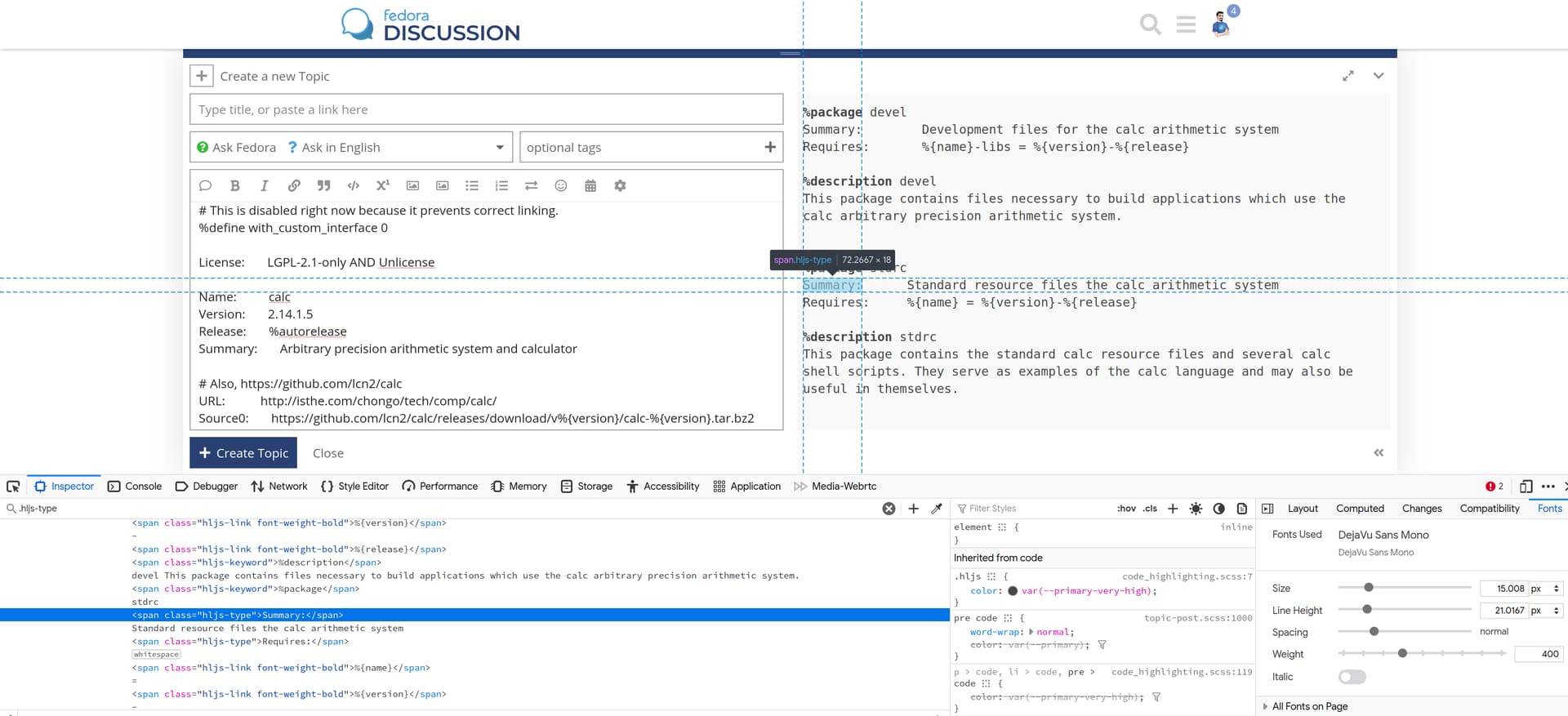

@falco — I had some time to look at this. Using Firefox’s built-in inspector, I can see that it properly add spans with classes hljs-type, hljs-keyword, etc. But if I look over on the styles side, I see a .hljs but not .hljs-type — only .hljs-keyword and .hljs-comment (the ones that work) seem to be there.
Oh, and .hljs-string also works. But I see some of the others in css … any idea what’s going on?

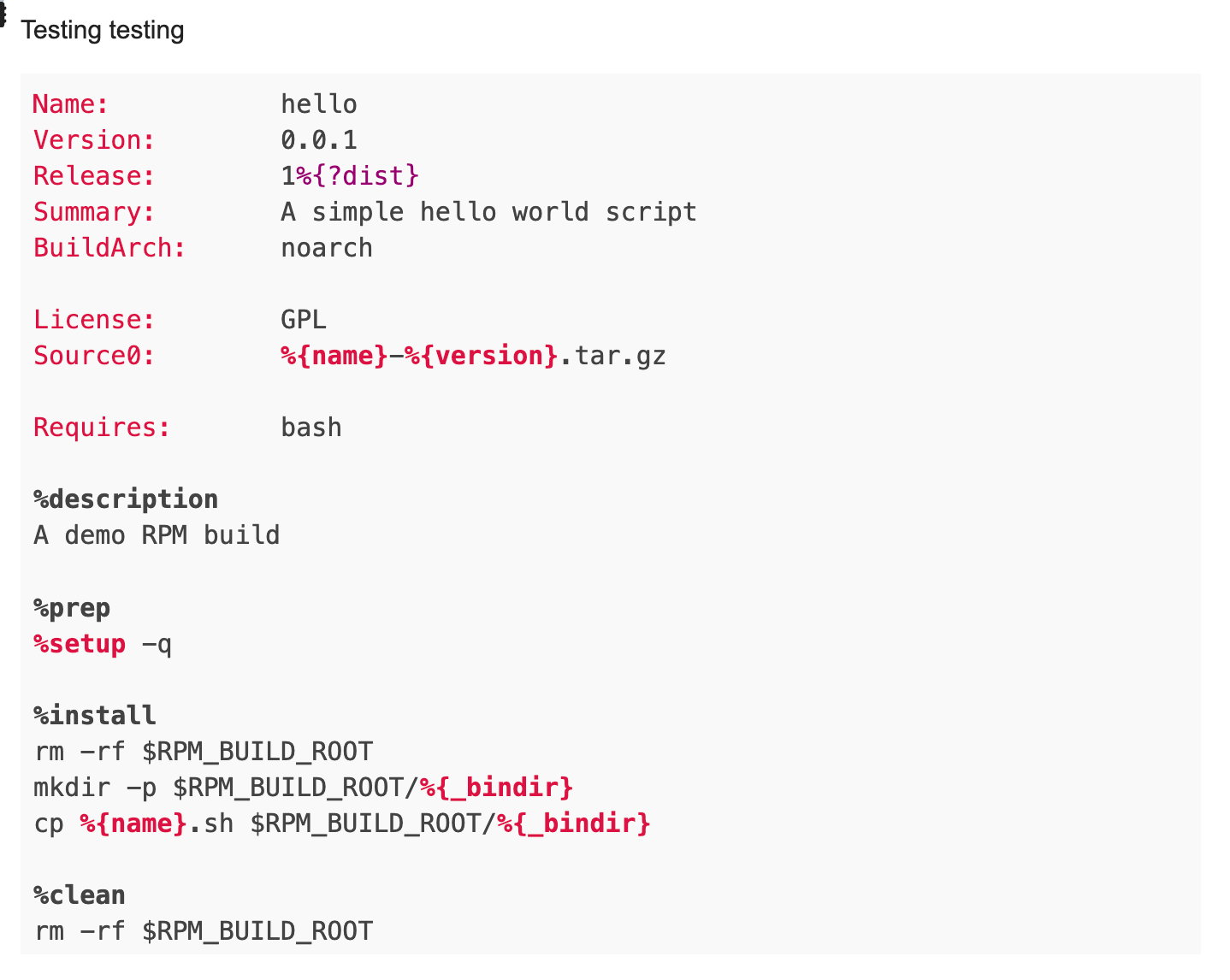

Looks like core was missing styling for the .hljs-type class. I’ve cleaned things up in this PR.
Exact colours will depend on your theme, but here’s an example RPM file:
Yep, works now. Thank you!
