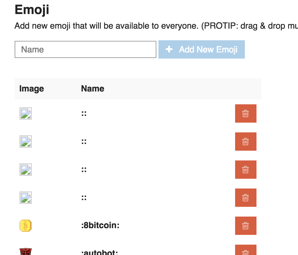

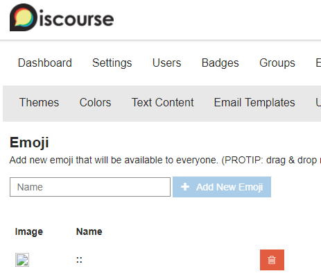

can’t seem to add new emojis… was working fine before update.

Can we repro @jomaxro?
Sure can! That should be a nacho emoji called test:
Ok this also needs some fixing @eviltrout
so much sadness… but, happy to help identify an issue!

@sam this commit broke it: FEATURE: uploads are processed a faster · discourse/discourse@eb428ef · GitHub Basically we are trying to access the url of the file when it hasn’t been uploaded yet.
