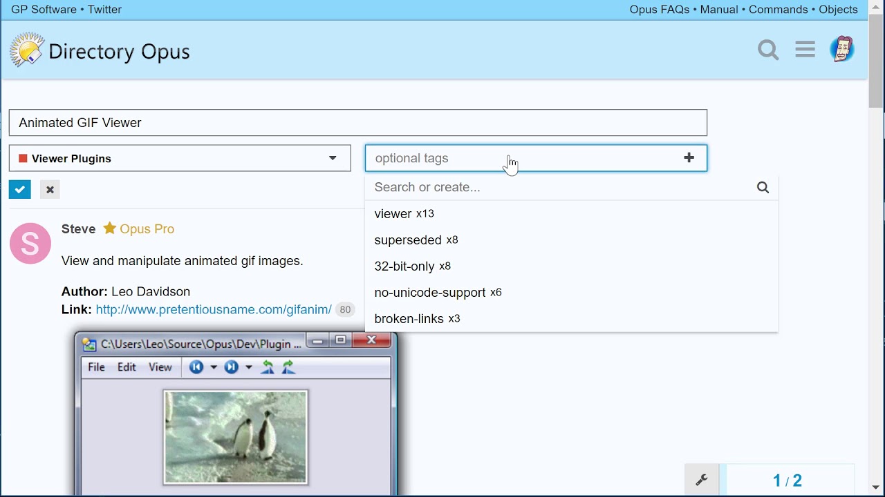

Nothing under /logs unfortunately. (Last error was 4 hours ago and unrelated.)
It is reproducible.
Here’s a video showing what I do and what happens, creating a new tag that has the same issue:
  1. Add “mtagtest” to three tag groups, saving each group in turn.
  2. Go to a post and try to add the tag.
    Note that it doesn’t autocomplete, but if you type the whole thing you can select it and it doesn’t prompt you to create it as a new tag. So some parts of the system seem to know the tag exists while others don’t.
  3. Save the post and it looks like the tag has applied.
  4. Refresh, and the tag is gone again.
Why it isn’t a problem with my older tag that is in two groups, I am not sure, but I can re-create the problem at will, it seems.

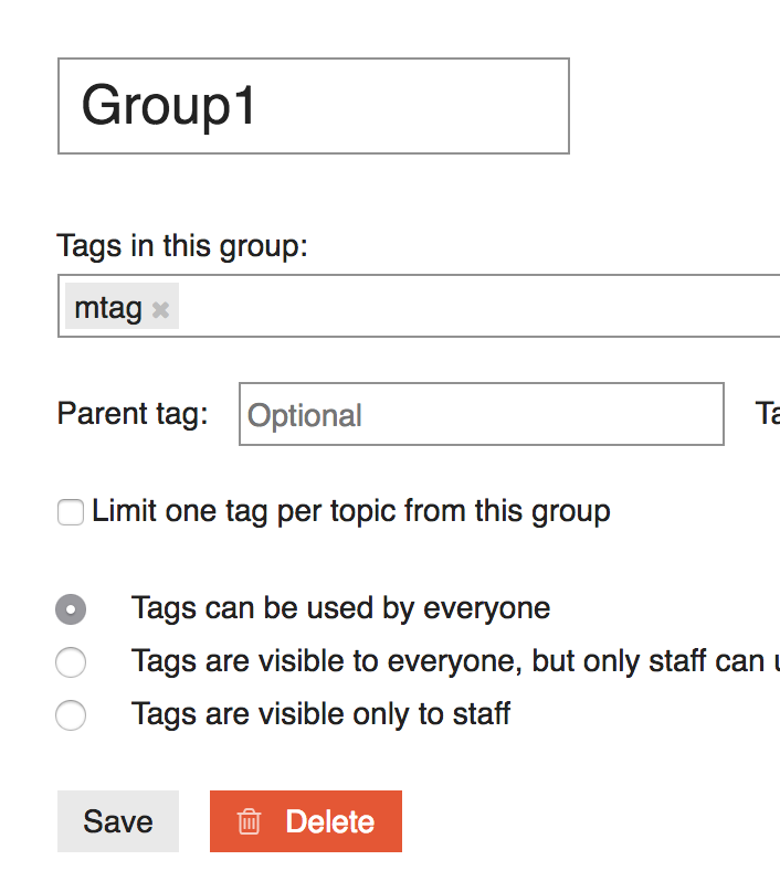

I can’t reproduce this with a tag that belongs to two groups.
Do your tag groups have any restrictions? Do the categories have any tag or tag group restrictions?
My tag groups look like this:
My category tag settings looks like this:

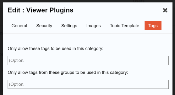

All my tag groups are the same, with no restrictions in the groups themselves.
The “Viewer Plugins” category I was testing with does not restrict tags to a particular group:
But three other forum categories do restrict them:
