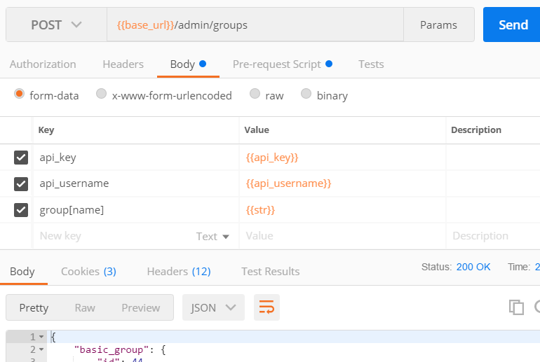

Ah understood. So the api_username and api_key in the query parameters and the rest in the post body.
They can also be in the body
All my Postman requests have them in the body:
Unless this route is special?
It’s not. The WordPress plugin sends the api parameters for the sync_sso route in the body of the request: wp-discourse/lib/sso-provider/discourse-sso.php at main · discourse/wp-discourse · GitHub
That’s correct, the problem was sending the wrong body type so the api_username/api_key couldn’t be parsed out.

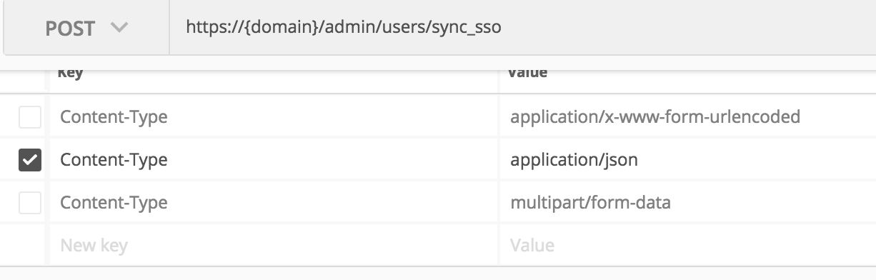

Hi
I am attemping the SSO sync but getting the no route found error. Im trying via postman.
I have tried adding the key and username both in the body and as request params, but same result.
any ideas?
hi,
could you elaborate on this… if using postman, what headers/values need to be set?
The Content-Type should be “multipart/form-data”, but I don’t think you have to set that in the header if the Body is already set to “form-data” (my Headers in Postman are all blank).
