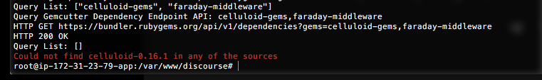

Hi all,
I’ve noticed that Discourse isn’t starting again after trying to update via sudo ./launcher rebuild app. Before there was an 404 error for some module (I guess some ruby package), so I’ve decided to update via console. Now, my server has stopped working at all… :frowning:
Here are the last couple of lines:
HTTP GET https://bundler.rubygems.org/api/v1/dependencies?gems=htmlentities,nokogumbo,bourne,redis-namespace,connection_pool,sinatra,slim,sprockets-sass,compass,rack-protection,shotgun,win32-process,simplecov-html,docile,lockfile,spork,libv8,ref,eventmachine-le,http_parser.rb,preforker,therubyracer,unf_ext,kgio,raindrops
HTTP 200 OK
Query List: ["celluloid-gems", "faraday-middleware"]
Query Gemcutter Dependency Endpoint API: celluloid-gems,faraday-middleware
HTTP GET https://bundler.rubygems.org/api/v1/dependencies?gems=celluloid-gems,faraday-middleware
HTTP 200 OK
Query List: []
Fetching dependency metadata from https://rubygems.org/
HTTP 200 OK
Query List: []
Could not find celluloid-0.16.1 in any of the sources

I’m receiving this exact same error. Any updates?
Yeah I’m seeing the exact same error when bootstrapping as well.

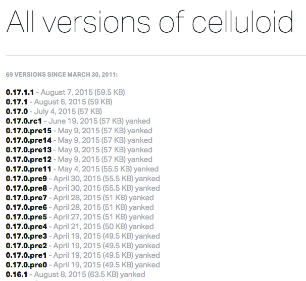

@neil found out they yanked that gem from rubygems :frowning: Probably a security issue. We’re investigating…
I’ve changed our Gemfile.lock so it doesn’t reference the deleted 1.16.1 release, and bundler seems to work again.
https://github.com/discourse/discourse/commit/113e8d62bac17e65c93e5535af45d3a1d2879d86
I confirm that it solved my issue.
Thanks!
