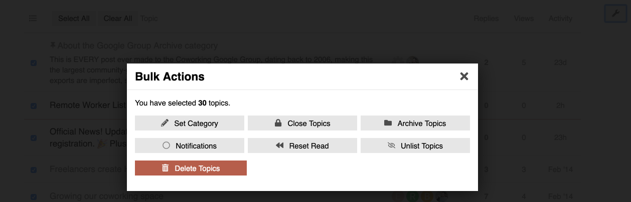

We had that problem, too. If I remember correctly, that best practice you’re looking for is to use the bulk actions for changing the category:
  1. In a list of topics, click the “toggle bulk selection of topics” button in the left top corner of the topics table. Checkboxes will appear for each topic.
  2. Select some topics.
  3. Click the wrench icon in the top right.
  4. Choose “Set Category” to change the category of these topics.
Please test yourself if that results in e-mail notifications or not. Pretty sure it won’t trigger e-mails, though.

If you click the bulk select button 11%20PM within the category that has all the topics, you should see a select all button. From there, a square button with a wrench icon should appear in the upper right of the topic list. Clicking that will open up the bulk actions modal where you should see an option to unlist.
