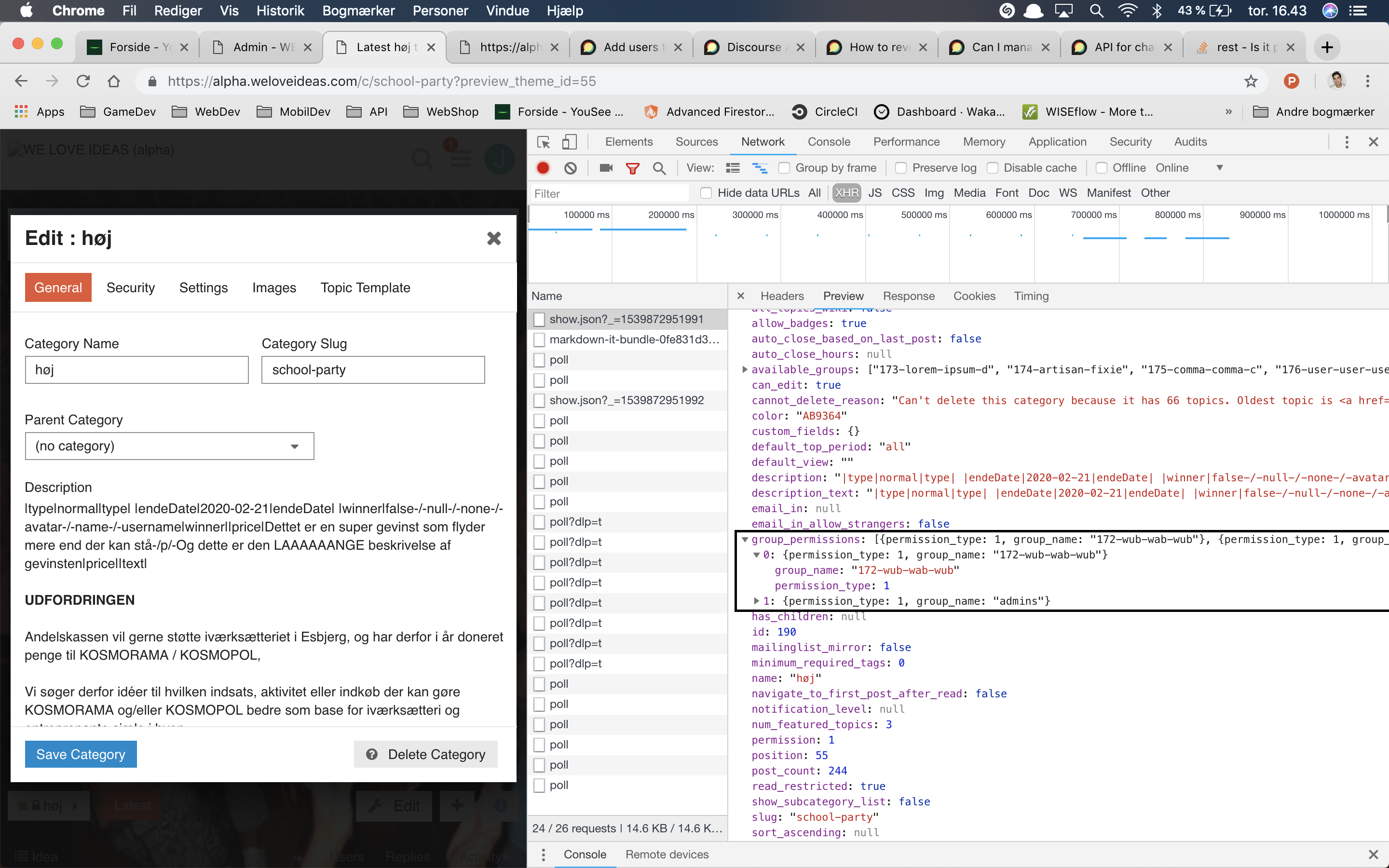

I want to change the marked property on the picture

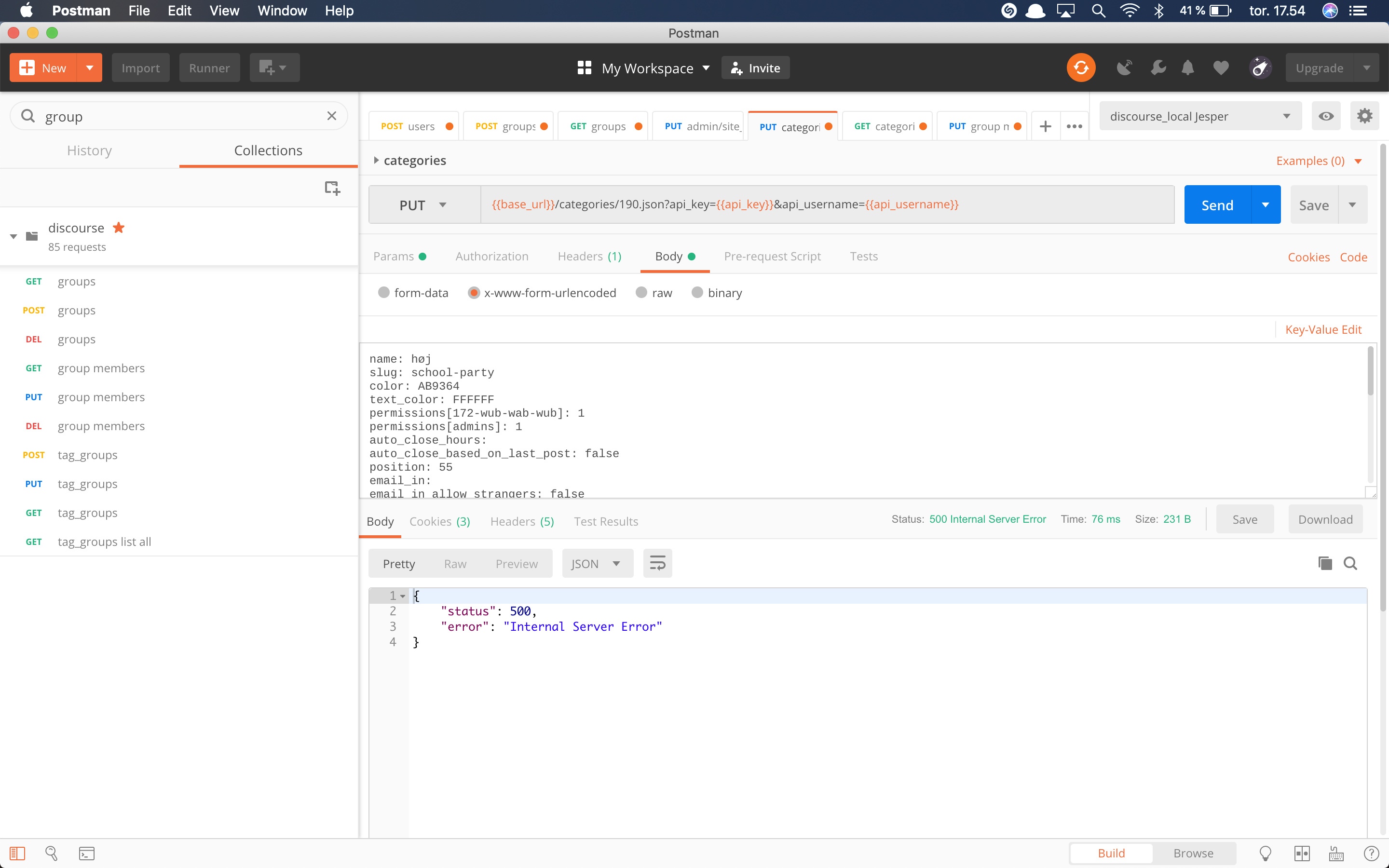

In the second picture you can see what i tried inside postman
The number used in the request i got from trying to reverse engineer it as seen in the last picture
Did I make some mistake in my put request?

Also, you are looking at the incorrect request in your developer tools. You should be looking at the request that happens when you click the “save” button. (You will need to tick “preserve log” in dev tools so that the request doesn’t dissappear when the page reloads). Look for a PUT request to /categories/192.
Another thing to watch out for is that your parameters need to be urlencoded. In postman, you do this by changing from “form-data” to “x-www-form-urlencoded”.

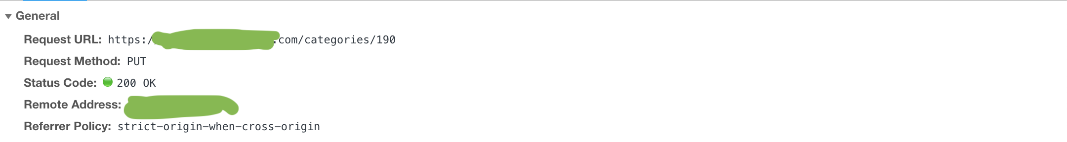

I can´t seem to find the right request
Okay. I Think i found the right request.
As seen in the picture below, then i want to change the permissions array.
I tried doing that inside postman, my put request returns bad request
You should not be using the “raw” option on postman
I tried that too

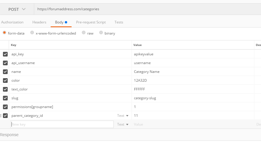

This is what I use when creating a category - I tend to use the form data however
Another thing to check is your error logs - this helps you along the path to be able to identify any calls are incorrect

no the name of the group goes in the [groupname] section
It does work - I use that exact set up all the time.
So I could write permissons[random grop name]?
works for me - as long as the group exists of course first.

It worked. Thanks man. You a lifesaver
