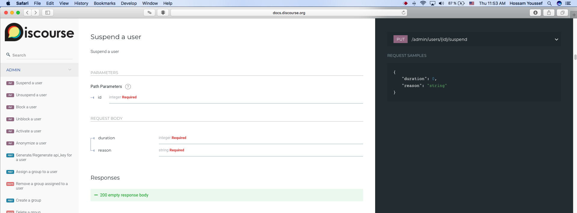

Hello,
I have found a wrong key which used in the PUT method to suspend an account which is making the suspend action not possible.
in the api documentaion:
API Request
    api_key:{{api_key}}
    api_username:{{api_username}}
    duration:2017-12-04
    reason:Reason Test Here
The expected response
Getting the account suspended:
            "suspension": {
                "suspended": true,
                "suspend_reason": "Reason Test Here",
                "suspended_till": "2017-12-04T00:00:00.000Z",
                "suspended_at": "2017-11-30T10:49:51.248Z"
The current response
Getting null value in the duration so “It suspend the account till ZERO TIME so it means UNSUPSEND”
        "suspension": {
            "suspended": true,
            "suspended_till": null,
The Solution
Replace the duration key to suspend_until in the body request and it works fine! like that:
    api_key:{{api_key}}
    suspend_until:2017-12-04
So I will appreciate if you could update this part in the API documentation. it could help others.
Thanks in advance!
