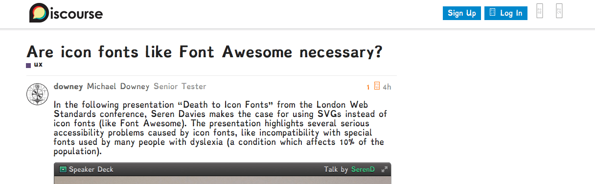

Are icon fonts like Font Awesome necessary?
In the following presentation “Death to Icon Fonts” from the London Web Standards conference, Seren Davies makes the case for using SVGs instead of icon fonts (like Font Awesome). The presentation highlights several serious accessibility problems caused by icon fonts, like incompatibility with special fonts used by many people with dyslexia (a condition which affects 10% of the population).
Is Discourse doing a disservice to 10% of its potential users by using an icon font so widely throughout the site? This presentation suggests it is. What do you think?

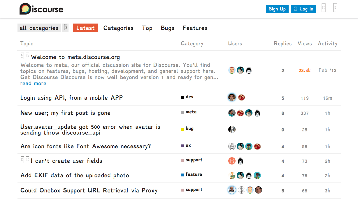

This is Discourse with the Dyslexie font installed on a mac according to the instructions that they include with the font.
Inline SVG would solve the problem.

It’s not limited to people using a dyslexic font. It’s people using any own-font, or having a browser that fights you, like my firefox (I can’t really see why it blocks fonts, but I had to go look up how to enable them in some freaky about.config setting and then several reboots later it somehow either reset, or I had to undo it to get ZoomText to work in firefox, where stuff like font smoothing and any other weirdness usually has to be off to make ZT work well).
(ZT is screen magnification)
I’ve gotten used to seeing boxes everywhere, and if it’s decorative, who cares.
When it’s the sole visible text of something you use, like a button or a call to action, then it’s a problem.
