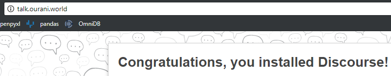

Just checked. Looks like you’re good.
http://talk.ourani.world/
Just spins and then either parks or says “The resource you are looking for has been removed, had its name changed, or is temporarily unavailable.” for me - working for you?
Cleared browser cache/cookies and still nothin’.
I’m guessing that because you were loading the URL, your DNS cache needs flushed.
I get this - perhaps because someone else opened it first? Thanks a ton (forgot about DNS cache) (: Noobs are annoying I know!
Edit - getting above “The resource you are looking for has been removed, had its name changed, or is temporarily unavailable.” on and off still
Edit again - working on mobile. Thank you so much!
