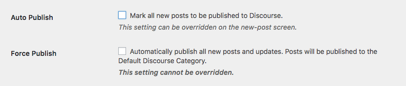

How did you manage to set up to auto post? I’m having this issue now.. To get one post, I have to manually activate the publishing to Discourse option. The same with allowing comments to edit on the post. When I do that and refresh the page, at that point the post is created and there’s a message about the possibility to go to myseite >> https://writemyessay.pro /blog/. How to make it possible to auto post on each topic?
The WP Discourse plugin has two options for getting all posts to be published to Discourse. Both options can be set on the plugin’s Publishing options tab.
If you enable the Auto Publish option, the ‘Publish post to Discourse’ checkbox will be automatically checked when a new post is created. This can be unchecked if for some reason you do not want to publish the post to Discourse.
If you enable the Force Publish option, all posts that are published on WordPress will be automatically published to Discourse in the category you have selected as your Default Discourse Category. Posts that are published through XMLRPC, for example, through the WordPress blogging app, will still not be published to Discourse.
