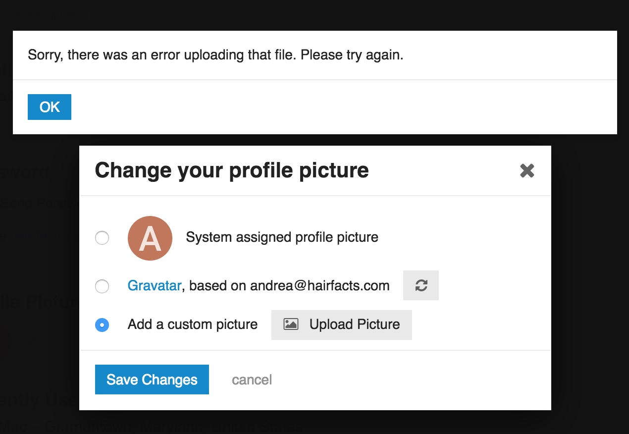

I’m having the same issue on a newly-installed forum running the latest and greatest version. The progress bar gets to the end of the upload then shows this message:
