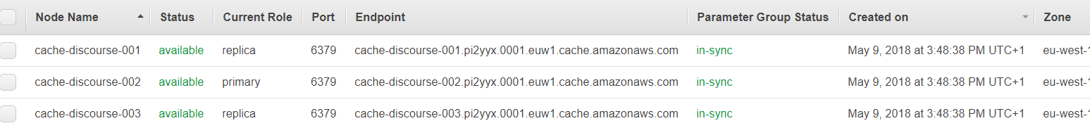

Yes ElastiCache is Multi-AZ. Setup is:

My app.yml specifies the primary endpoint of the cluster.
