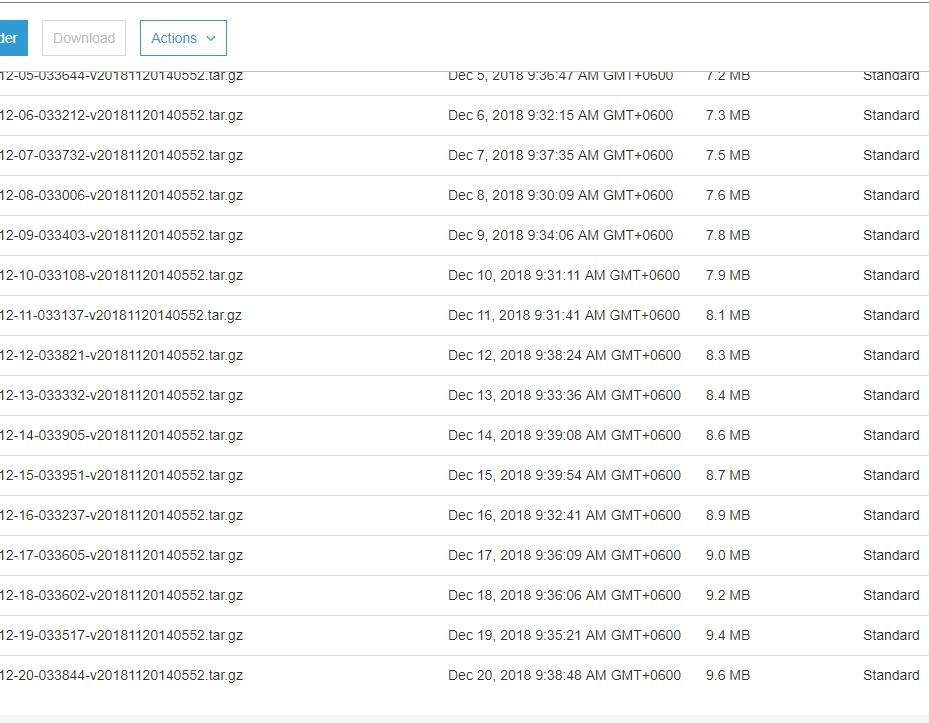

I notice on a new (<1 mth) install of discourse the backup size increasing by a steady 0.2Mb / day.
Any thoughts on what grows day by day if new posts are not added?
Backups are to S3, but I’m wondering if it’s backing up backups.
I haven’t torn apart the gz’s yet.

It’s the DB growing by about 2MB / day which is about 0.2mb compressed.
Not a big problem, but interesting if the growth is continuous.
