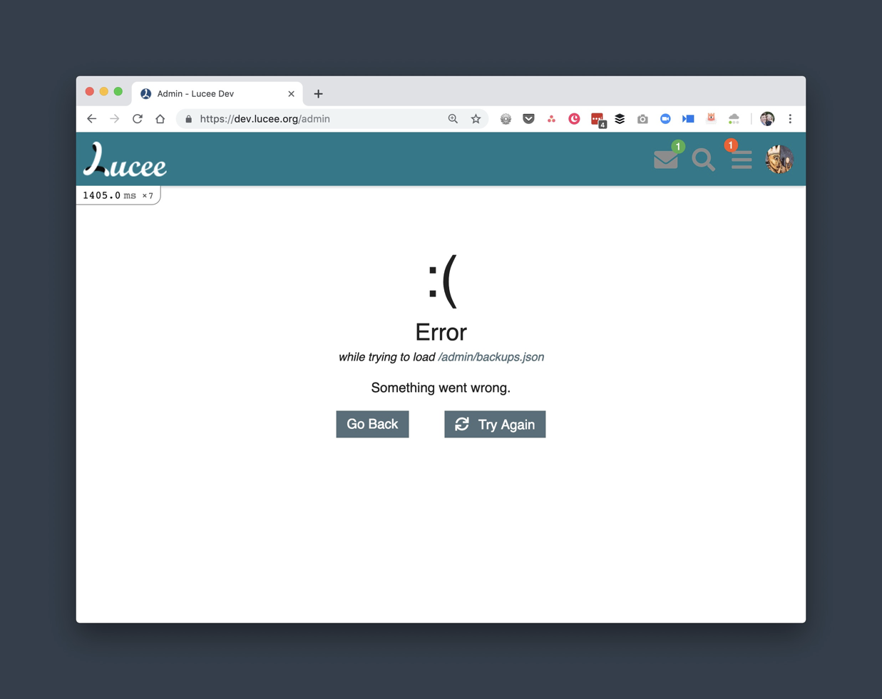

Going to the web admin screen for backups gives me this error… which is not much to go on:
Are there any other logs I should be looking at to shed light on the problem?

Weird.. could have sworn i tried to click that link before. It yields more mystery :wink:
{"errors":["The difference between the request time and the current time is too large."]}
