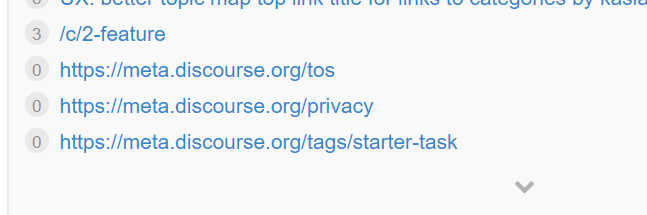

Hello,
let’s say I link to a category: #feature
The topic map top link will read /c/feature or something like that. It would be nicer to have a title like Feature Category.

I don’t understand what the “The topic map top link” is
I have found that name somewhere in the forum. Here, it is under the caption “Popular Links”:

Lets test this out: https://meta.discourse.org/tos, Privacy policy | Discourse - Civilized Discussion, /faq
Hmmm: yeah
<a class="hashtag" href="/c/2-feature">#<span>feature</span></a> yeah this thing needs a title which our CommonMark engine should provide and then a proper fix would flow.
Wow this is pretty messy for internal links:
looks like mini onebox is not setting title…
Yeah simply adding title for internal links would be best there. I think you meant to say ‘topic map’ in your last sentence as well?
