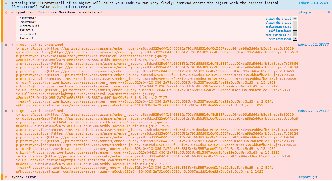

On the server-side nothing’s wrong. The /logs/report_js_error contains only OK which gives a syntax error. See screenshot below.

Still have an error though in the console:

No it’s the console on any page, running the master branch at PERF: Remove `Object#present?` check introduced in https://github.com… · discourse/discourse@58321d0 · GitHub (the one after your fix to that bug you mention.)
Commits · discourse/discourse · GitHub still mentions the build failing… I’m going to wait until test-passed includes your fix to revert to that branch.
If the Discourse.markdown error is on every page then maybe it’s not the same issue. What plugins do you have installed?
OK, thanks for your interest @david, but I guess it’s a different topic. I resolved the blank page issue by switching to the master branch that includes your reverts. Now, on the master branch, there’s still this Markdown issue that doesn’t seem to affect much of the site use.
