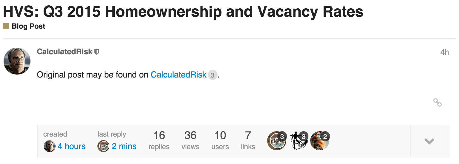

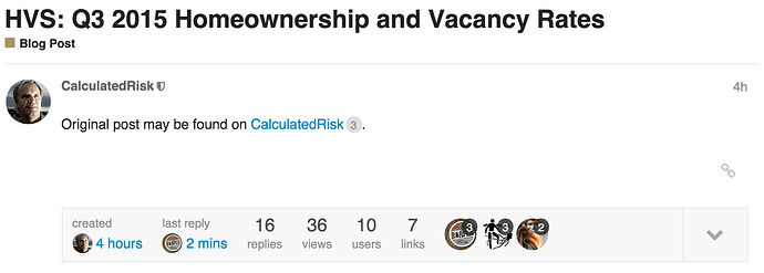

Ich habe Screenshots zur README-Datei hinzugefügt.
Hier ist ein neues Thema, das erstellt wird.
Und hier ist ein Beitrag mit der Benachrichtigung „Neuer Beitrag!“, der zum vorherigen Thema hinzugefügt wurde:

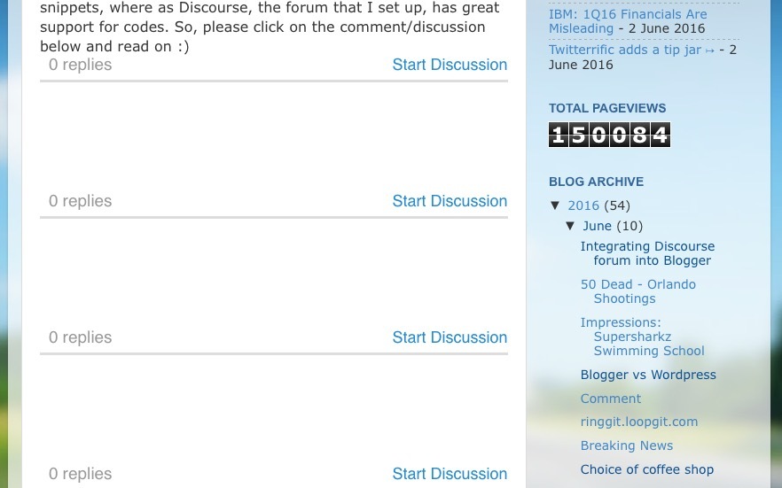

The integration went on fine but if I view a group of posts base on a tag, or base on month, Blogger returns, say 3 articles with the same tag. Then the embedded Discourse will show 3 times in the first post, as per screenshot below.
I think it has to do with placement of the codes but I am just too tired at this moment to think about it :slight_smile:
I just looked back at my site, and it follows what I wrote in Blogger Template Configuration in the README.

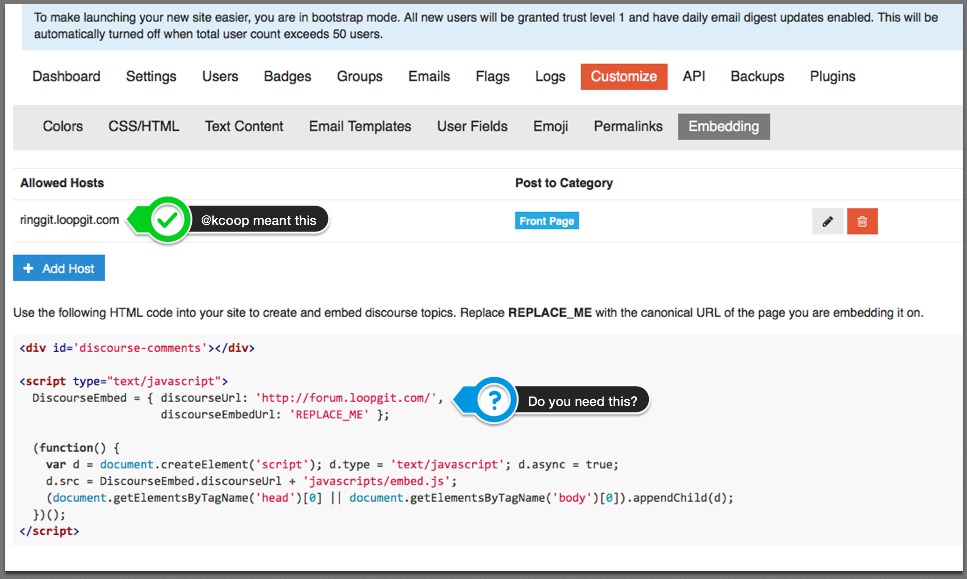

The codes containing REPLACE_URL is a code snippet in the Settings of Discourse, in which you have to include into the Blogger template, according to the embed documentation. I wondered if the embed part is necessary and I guess you meant assigning the host is needed but not including the codes into the Blogger, as illustrated:
