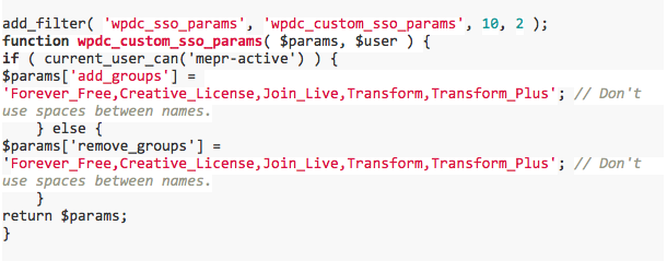

Simon, if i want to use this for ALL my membership levels, would it be enough to just say “current_user_can(‘mepr-active’)” or would i have to include all the active ID’s?
There’s five groups and i need the user to enter the group he has paid for.
If they change plans, that should be reflected in their group.
Based on what Andrew used, i have this:
does that make sense for my situation?
thanks!
The basic idea makes sense. current_user_can is a WordPress function. Its documentation is here. I think that in this case you are fine to call it without the $object_id argument. If MemberPress adds mepr-active as a role or capability to users when they sign up for any membership level, and removes the mepr-active role or capability when the membership expires, then it will do what you are looking for.

Edit: i can try adding the membership ID’s. what would be the way to add Numerous ID’s?
Like so: current_user_can(‘mepr-active’,‘memberships:12856,12345,12346’) ?
i came up with this:
add_filter( 'wpdc_sso_params', 'wpdc_custom_sso_params', 10, 2 );
function wpdc_custom_sso_params( $params, $user ) {
 if ( current_user_can('mepr-active','memberships:47281,47295,47299,47303,47297,47301,47305,48259,48238’) ) {
$params['add_groups'] = 'Forever_Free,Creative_License,Join_Live,Transform,Transform_Plus';
} else {
$params['remove_groups'] = 'Forever_Free,Creative_License,Join_Live,Transform,Transform_Plus';     }
return $params;
but the plug-in tells me “This causes a fatal error so it hasn’t been applied.”
i tried with and without spaces: ‘memberships:47281, 47295’ but both options are rejected.
If the code you used is exactly the same as what you posted here, the problem might be the curly quotes in your code. Try this code. I’ve also removed the $user parameter in the function call, since it’s not used:
add_filter( 'wpdc_sso_params', 'wpdc_custom_sso_params' );
function wpdc_custom_sso_params( $params ) {
	if ( current_user_can( 'mepr-active','memberships:47281,47295,47299,47303,47297,47301,47305,48259,48238' )  ) {
    } else {
	return $params;
