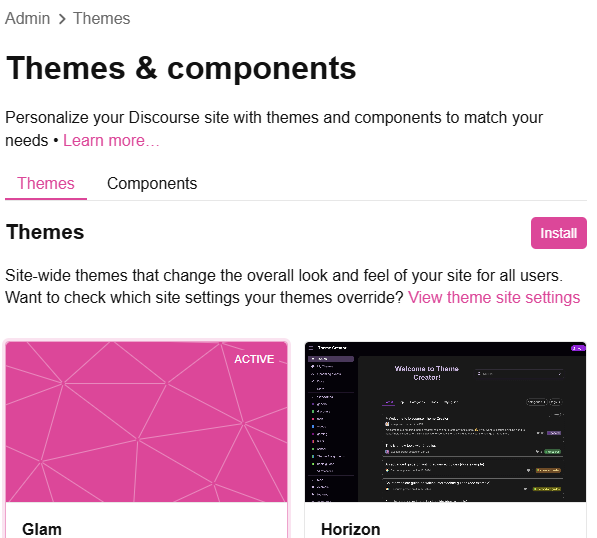

A recent example are the themeable site settings which were merged on a Wednesday. In that case the description of the themes page was extended and “Theme settings” was changed to “Custom theme settings”. In English, this change helps users find the new location where these settings are configured. But in German, I don’t see that.
I have to wait for the Crowdin translation update - and then it also depends on when my site is updated. So it takes even longer before I get the updated text.

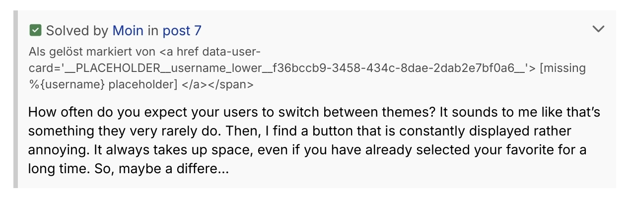

It is an issue. You can check any solved topic here on Meta while your interface language is German, and you will see something like
and an error in the browser console
And in this case, it took me a long time to understand the problem because the new text is not yet on Crowdin, and I thought I broke the HTML. (Thanks again for the explanation @nat)

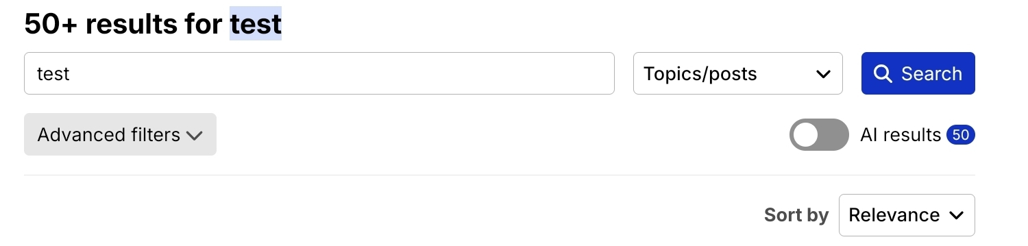

Another example where the result would be better if translations were removed right when the English text is changed instead of a few days later.
This is how it looks in English.
And this is how it looks in German. Since the text is still long, the number at the end looks a little lost, and the count at the beginning now results in a missing value.
In such cases, a script, similar to the one martin recently created to update keys, could be really helpful. So translations are removed in the same PR that changes the placeholder instead of after the next update from Crowdin happens.
