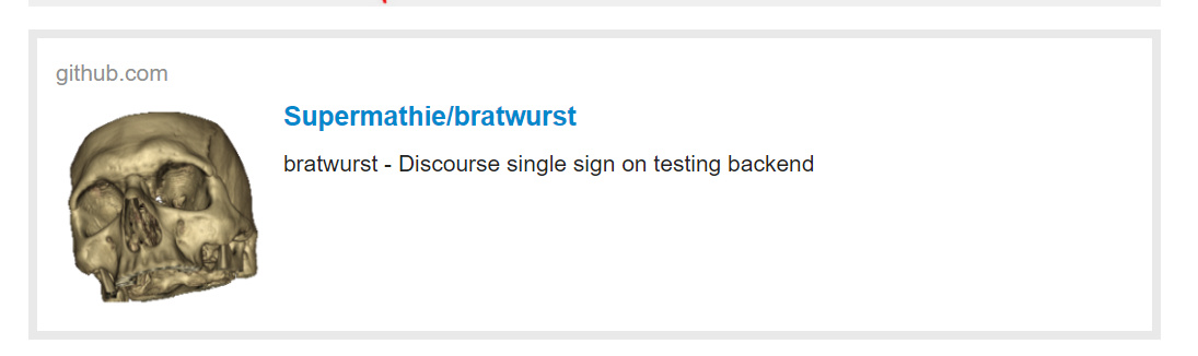

Question for @awesomerobot at the moment our oneboxes have height / width set to auto in the images. EG:
https://github.com/Supermathie/bratwurst
This cause pages to Jiggle when the image finally loads, despite us having the exact dimensions.
I was wondering if you can think of some workaround here where we can avoid this? Are we going to need to amend something server side to size these images down.
(keep in mind we need to account for mobile here as well)

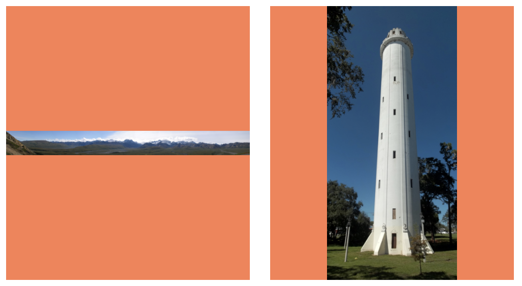

Right, the only way I can think of doing this with CSS-only is doing something like
.wrapper {
  display: flex;
  width: 20%;
  height: 170px;
  justify-content: center;
img {
  max-width: 100%;
  max-height: 100%;
  align-self: center;
But you’re creating a container that will typically have some amount of whitespace around it unless it happens to match the 20% x 170px aspect ratio (which is variable because of the 20%). That could look something like this in situations with extremely tall or narrow images (I set the background of the wrapper to coral, to emphasize the extra whitespace)
4 « J'aime »

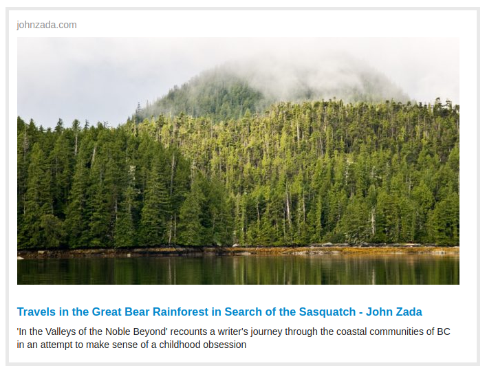

Facebook crops their preview images to either a small square or a large rectangle, based on the image size and dimensions. If the image dimensions are way off the map they don’t display it at all. A lot of sites are setting their og:image to get it to display well on Facebook, so it might work to follow the same rules. This would probably only make sense if you wanted to make large rectangular images display at a larger size in the onebox.
vs
http://www.johnzada.com/sasquatch-bigfoot-canada-british-columbia-great-bear-rainforest/
7 « J'aime »

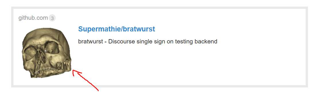

This is now fixed per:
https://github.com/discourse/discourse/commit/9197feefb867fa1a028ae68b6ddc930119689600
The non-jittery-ness will be present on all new posts or rebaked posts as we needed to make some internal html changes. (note that the post processor that downloads images must run first which may take a minute or 2)
The non-jittery-ness works fine in all modern browsers (edge,firefox,chrome) but old behavior remains in IE.
It is implemented using serious levels of voodoo and CSS vars described here:
