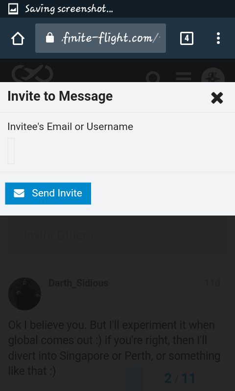

Can't add people to a PM
Whenever I click “Add person”, this comes up
Then I type anything, it always comes up with this (because it isn’t registering my inputs)
(Can’t add 2nd pic, but whatever I type it just shows @Rishi_Bokhoree)
I can’t add anyone, which is really annoying
If you just type @, he’s the first person to come up
(And I’m not trying to add Rishi_Bokhoree to my PM)
Thanks in advance

Update - more people on the forum complaining about it. Seems to be an android only issue (works on Safari, yet not on chrome nor Samsung internet)

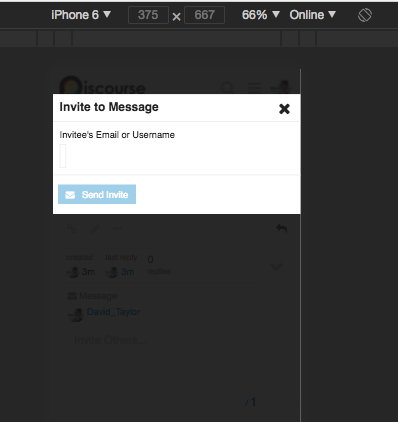

I can repro on chrome stable here on Meta, but only if I use the mobile emulator.
I cannot reproduce on my own instance using my own account, but can repro with a non-admin account. So looks like the issue might be for non-staff users only. Nothing in Ruby/JS logs.
OK, I have an easy repro here @j.jaffeux so adding this to your list.
  1. Create a PM to yourself
  2. View it with ?mobile_view=1
There are 2 bugs here:
  1. Why does this not look like a button?
  1. What is going on here?
The reason I am assigning this to @j.jaffeux is cause this issue is made about 9000 times harder to debug due to select2.
With select2, we always replace the original DOM nodes with a wrapped version using select 2, which means finding the original CSS responsible for the width of the element is a nightmare ^ 2.
So my suggestion is just to replace user-selector with the new component and then it should be trivial to add the missing width there.
