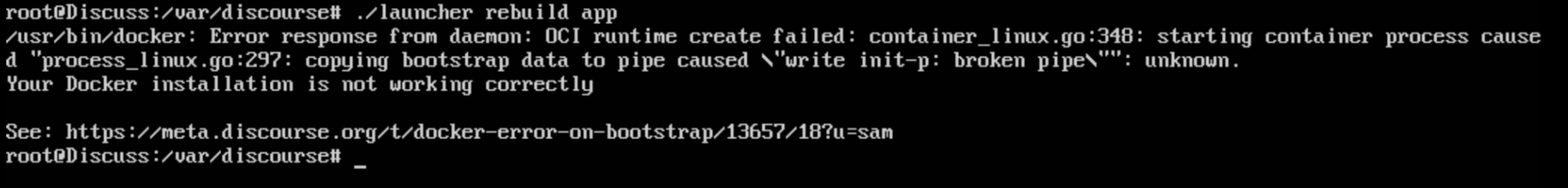

I tried to rebuild but get this error and the link appears to be broken.
Looks like you have a docker problem. As you still haven’t answered my questions above there isn’t really much to go on here:

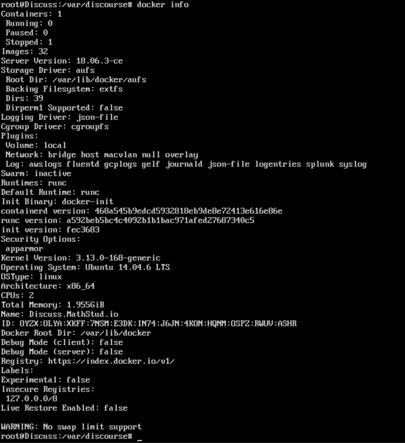

What’s the result of docker info ?
It’s installed on a Digital Ocean Server. I installed it a few years ago. It was installed using the instructions on your website. It worked perfectly fine up until a couple weeks ago.
According to that your Discourse instance is stopped.
See the fifth line: Stopped: 1

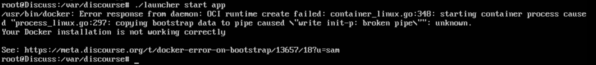

try:
cd /var/discourse
./launcher start app
What happens?
I am updating Troubleshoot docker installation issues which is the topic we pointed you at with debugging steps.
