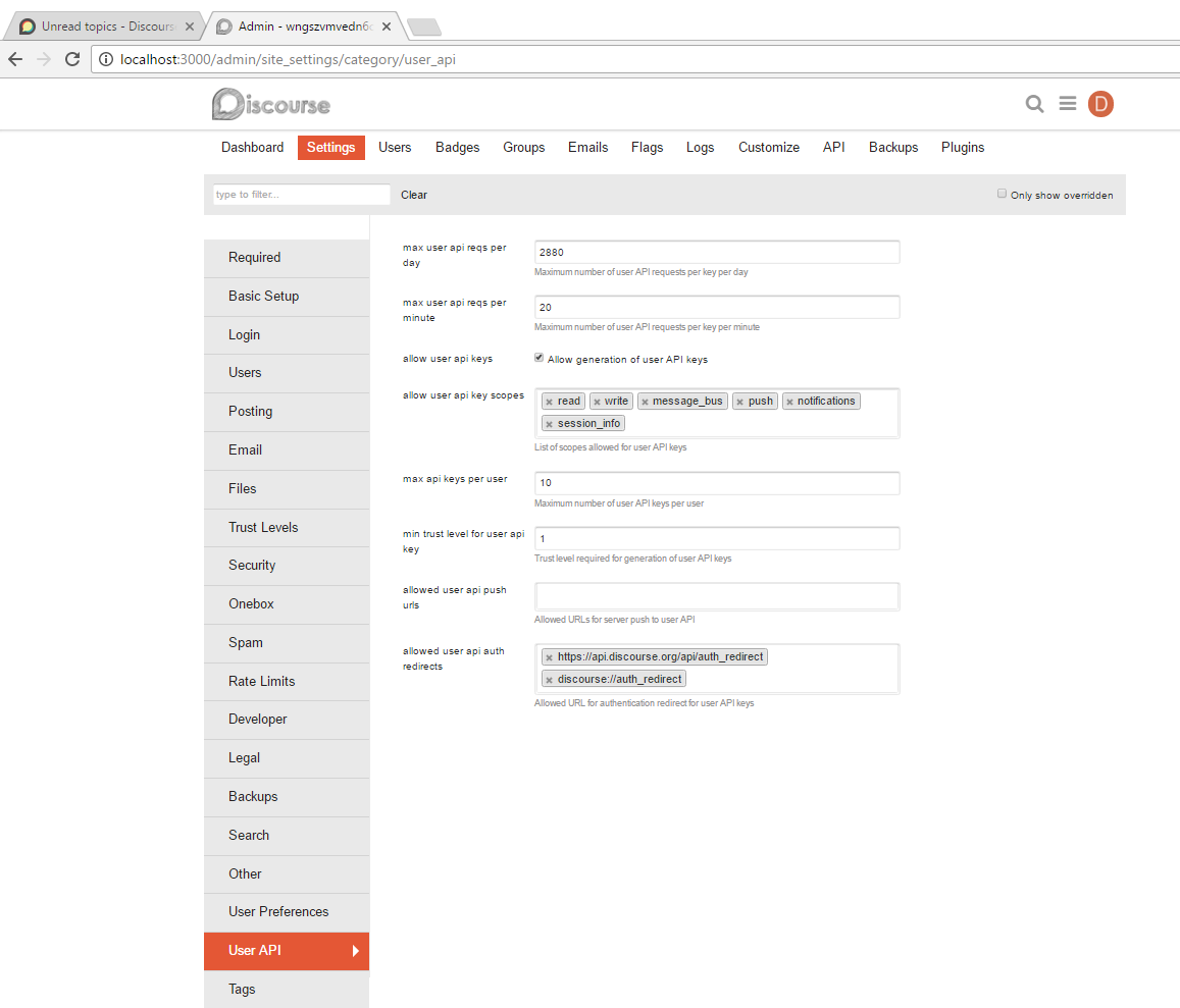

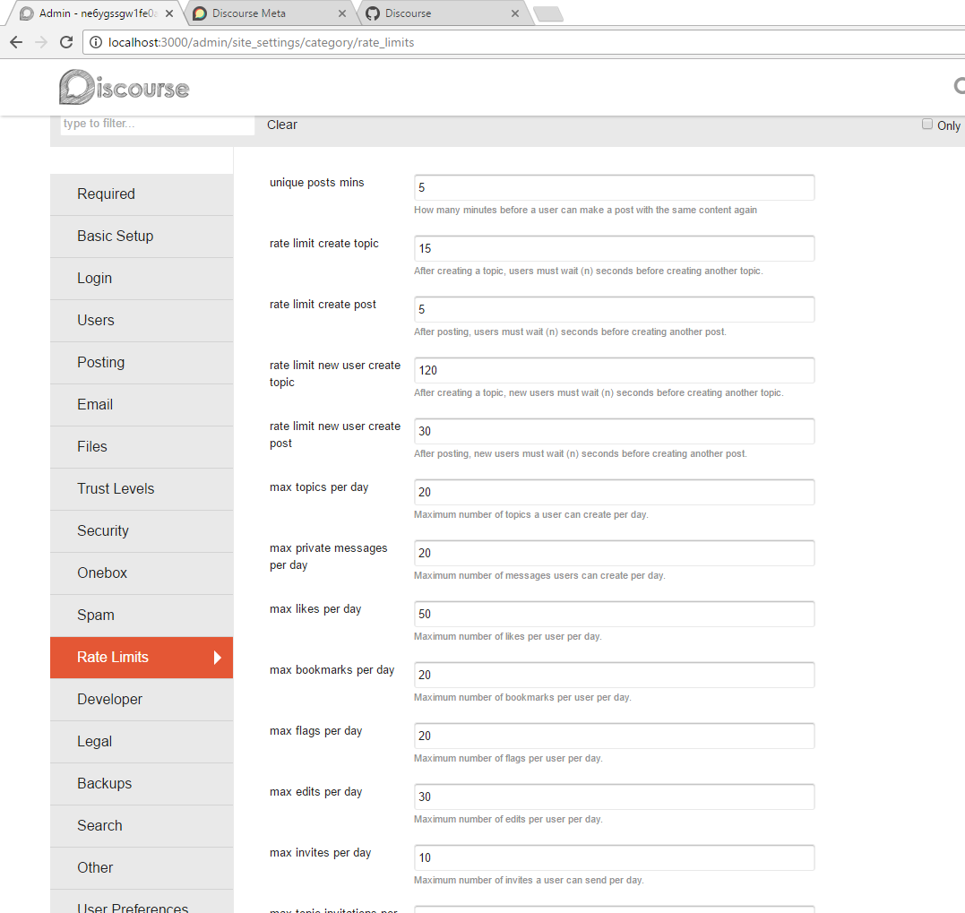

If I remember correctly, there are a few exceptions, like being exempt from some rate limiting – maybe a team member (@sam?) can clarify this?
I think there are some specific api number of requests rate limits, but I would think these user limits would be hit first:
I’m pretty sure that the user API is distinct from the API the admin-generated user API keys work for ![]()
