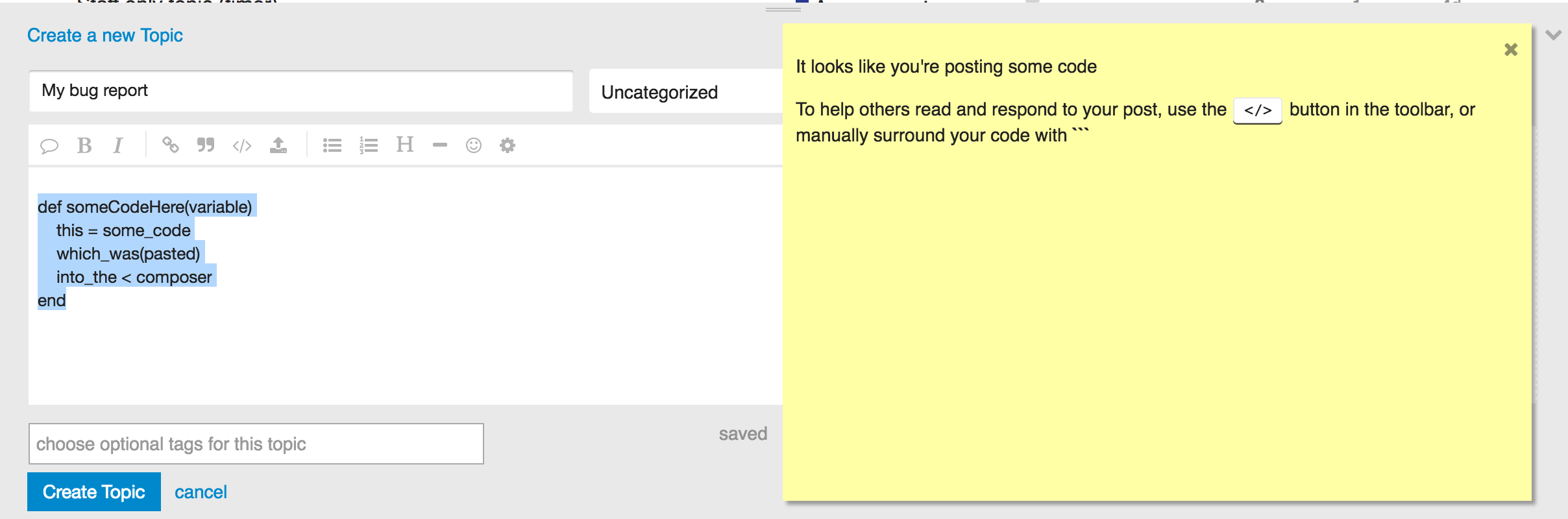

The concept already exists - try creating a brand new user on try.discourse.org, make a topic, and you’ll see it.
So you could have something that looks like this:
4 Mi Piace
It’s whenever we save a draft.
That looks perfect. It doesn’t block the actual typing and editing, users can click it away and ignore it, there is actually enough space to really explain the task.
Only drawback is that it covers the preview where the actual difference the code formatting make is hidden. Any workaround?
Saving a draft also sounds like a reasonable moment to trigger this.

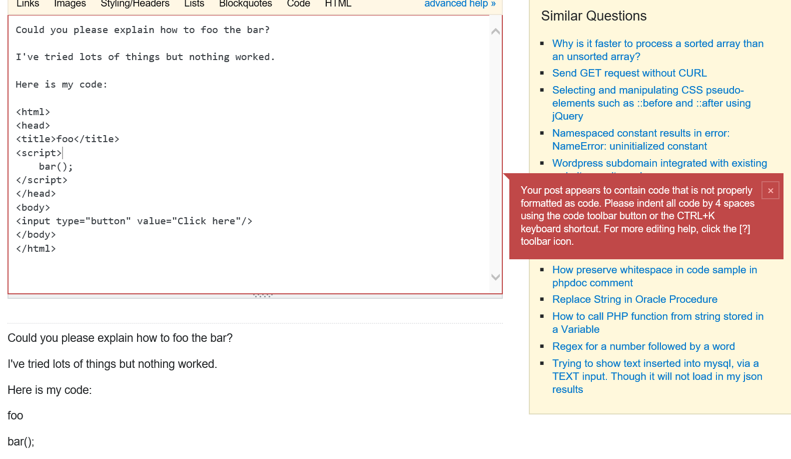

Any chances you could “steal” what stackoverflow is doing? They probably put a lot of thinking into this. No point in re-inventing the wheel.
Would make sense, but my Google mojo didn’t turn anything up - it’s somehow pretty hard to google about some helper functionality to format code on StackOverflow :wink: @codinghorror, can you help out where to look?
This looks great, but could you please (pretty please with sugar on top) share some more details on how to implement ComposerMessagesFinder for catching users pasting code?
Let us say that I would like just to cover C/C++ so it would just detect semicolons, and { } curly braces. Could you please offer some documentation on that? Should I just modify composer_messages_finder.rb (I am not familiar with Ruby, so please excuse my ignorance, how do I catch “Paste” event in Ruby?
