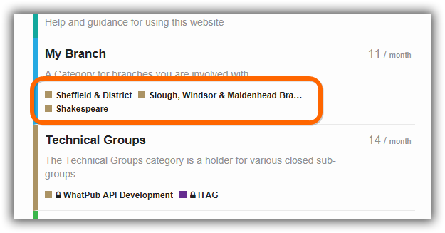

The main problem here is the list of categories starting to swamp the user interface plus confusion by users as to which category to start a topic in. I’ve been partially successful in getting them to reduce the number of categories down.
But there is a problem looming. Historically most branches had their own private Yahoo group for local discussion. It works okay but there is a desire to move away from Yahoo (don’t blame them!) plus there is no easy way to manage whether a person is a CAMRA member or not, i.e. authentication isn’t linked to the membership system - which Discourse is.
So centrally they have decided to migrate all 200 branches to Discourse. And by default, everyone will see all the branches which will flood the UX with a very long sub-category list, the sub-category dropdown list will be unmanageable plus user’s timeline will be flooded with posts from branches which they are not interested in. Imagine what this list would look like with 200 entries in it:
I’m aware that you can mute a category but that’s too draconian. Once muted, it’s very hard to find that category again. Out of those 200 branches, there is my own branch that I’m interested in but I’m also occasionally interested in some of the surrounding branches. At present, I use an Outlook rule to move those messages into their own sub-folder and I go look at them when I’ve got a moment spare. I don’t want them in my main inbox as that’s more higher priority stuff. I guess what I’m saying here is that this very useful idea of rules/separate folders mentality doesn’t work in the much flater Discourse “Latest” and “Unread” views. Is there a solution here?
There is one other side effect of this category creep. Many CAMRA members are well over 50 and “Don’t do IT” (see comments about markdown). They really don’t and are proud of it. So one has to strive to make everything as simple as possible. Consider one branch being migrated to Discourse where they can see all open groups by default - they are going to be presented with a huge list of topics none of which are anything to do with their local branch. They are going to switch off immediately as they won’t be able to see the wood for the trees.
My suggestion was that when a member is added to Discourse as part of a branch migration is that they only see two categories by default: the welcome category and the branch category (or probably sub-category). After they’ve been using the system for a while, they receive an email telling them about the rest of the categories and they can then go an subscribe to the categories they may be interested in.
Is any of this possible in Discourse? I think I’m sort of asking for a self-help subscription type system whereby you are presented with a list of all the categories and you can check/unchecked your membership of those categories - some of them may require further approval. Some of them are open and you can go straight in.

I may be wrong as I have not implemented this, but you could achieve this with Groups instead, no?
It would mean a bit of set up for each Branch (sub) category but you could create one for each branch and make it only visible (in its security settings) to members of the appropriate Group. Then you create a list of groups and get members to subscribe to their branch (and any others they are interested in). These could, in theory, each have their own sign-up rules.
I guess you could achieve this by making all other content visible to members of some generic group that gets assigned automatically the moment they select a branch (i.e become members of Group:BranchX and Group:AllQualifiedMembers).
It would mean that there would be little content to show unless you registered with a branch, but that would make the instructions clearer.
However, if you are managing the migration using SSO it might be possible to them pre-assign groups to each user depending on their source, skipping the initial step at least, see:
https://meta.discourse.org/t/official-single-sign-on-for-discourse/13045/255
Would that work?

I have tackled some of theses issues by
  • making categories restricted to certain groups, except for a top level Welcome category for users not logged in
  • setting main site categories to viewable by TL0 so logged in users get the content common to all users
  • using the groups page to allow users to “follow” restricted categories
  • suppressing subcategories on hamburger menu
  • adding a groups icon to the nav
This works ok for me, including creating a curated email summary for the groups that each user follows. See https://community.talkbaq.org for an example.
At scale, the menu and groups page gets unwieldy. Some ideas to consider
  • group page enhancements to help with order and arrangement, “My Groups,” group categories, show group description/dated added, search, orderby (clickable) options, etc.
  • simple category overview page that shows all categories and subcats on one page like a sitemap
  • The new changes are great but further enhance the preference page for Categories to add a “check the box” interface.
  • Show groups on profile in more pretty way and under separate tab
  • Preference page for categories or groups page could be part of registration flow to let users pick their groups/categories.
  • Allow generic invites not tied to an email so communities can be transitioned in more easily with group assigments when you don’t have a user’s email or you want the invite to be shareable (used with caution)
  • As an alternative to groups approach. allow categories to be private but not hidden, so users know the categories exist and can get instruction in the about topic on how to join.
  • Above all else–should work on mobile.
The downside to all this for me is it takes everything out of search because categories are restricted. Also users have to jump through a couple steps.
