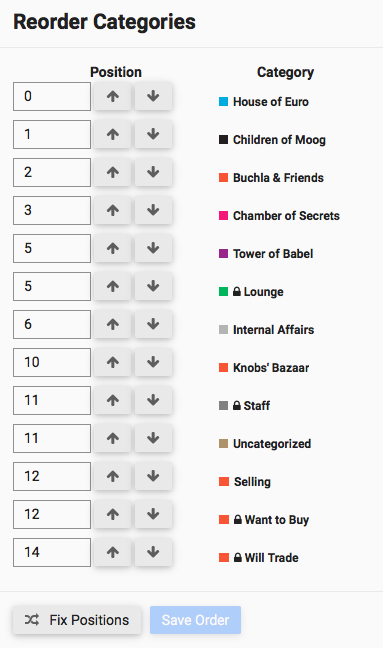

Category Reordering UX could be simpler
  1. do we really need to see the column with numbers?
    this feels like an under-the-hood info, that should be hidden
  2. the [Fix Positions] button is redundant.
    pressing [Save Order] should fix position before saving.
  3. drag-&-drop for reordering would probably be more intuitive than arrows
Agree here. I’m not sure if there’s a good reason for it that I’m unaware of, but it definitely seems redundant when I’ve used it.
I’m not so sure about that, drag and drop interfaces can be incredibly annoying especially with very long lists. Some sites may have dozens of categories, and scrolling while dragging and finding the correct place to drop can be frustrating. If I have a list of 50 items and I want to move item 49 to position 1, it’s much easier to use the number input.
I see you point about handling a large number of categories. OTOH, typing numbers to move a list item feels like MS-DOS era. How about drag-and-drop and a move-to-top button?

Drag-and-drop and move-to-top as a replacement remove functionality… we’re making the UI less specific and requiring more steps for certain tasks. What if I want to move item 50 to position 10? I either drag past 40 other items and hope I don’t mess up (which can cause me to have to start the process all over again), or I have to click “move to top” and then drag. It’s less exact and requires at least 2 clicks if I’m doing everything perfectly. If we call for the numeric keypad on mobile (which we’re not at the moment), tapping an input and typing 10 seems at least as fast and less prone to error.
I strongly disagree that this is universally true. It depends on the circumstances. The longer a list gets, the more difficult drag-and-drop becomes to use. It’s a fringy but not completely uncommon for sites to have more than a hundred categories. Drag-and-drop only would make category reordering a nightmare for them.
I’d argue that’s it’s not problematic, but almost completely broken if it’s the only option for sites with large numbers of categories.
I’m not completely opposed to drag-and-drop, we just can’t sacrifice numerical input along with it. I don’t think it would be a problem to eliminate the up/down arrows for drag-and-drop, in most cases drag-and-drop is probably nicer than clicking an arrow over and over again.

Would just leaving the category position box in the Category Settings be an acceptable compromise?
P.S. I apologize for making a clumsy MS-DOS reference. I didn’t mean to imply that a UX method is bad just because it’s old.
I for one certainly think so, yes. I was never suggesting that we should remove it in the first place. There’s ample space for both UI solutions in this case, and they both have merit.

We do not support adding drag-and-drop. We are not too enthused about doing a giant UX redesign of the whole reorder menu.
Going to add a pr-welcome on remove fix order AND auto correct sub category position on save.

PR’s up :wink: Also took the liberty to improve the move up/down button (assign the correct position number)
https://github.com/discourse/discourse/pull/6149
Before:
After:

Looks great! what happens if you fiddle with the numbers in the textbox?
Is there a reason to permit that? Why not make them labels? (just asking)
I guess one could argue that it makes moving first to last way way easier… that said there are workarounds.
I think the behavior I just merged is fine though, it just fixes up on save and reflects in the UI… Just want to confirm it “fixes everything” not only numbers but position in the list.
That behavior remains unchanged: it will move to the position the number specifies. Should there be a position collision, Save will automatically correct it.
And yes, both the previous & the new flow manipulates the actual position value.
I imagine it makes moving up/down by more than one easier.
