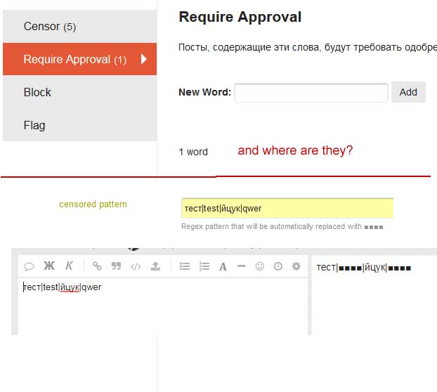

1. Where to find words? (how to delete, etc.)
2. Russian characters not working
(v1.9.0.beta4 +317 1.9.0.beta4)
This does not look like a regression, I think it never worked:
This regex does not work with Cyrillic .
Anyone have any ideas on how to rewrite:
censorRegexp = new RegExp("(\\b(?:(hello)|(Здравствуйте))\\b)(?![^\\(]*\\))", "ig");
So it does not use \b which is unsupported Russian.
(be sure to reply here with a tested regex I have already seen the posts on Stack Overflow)
