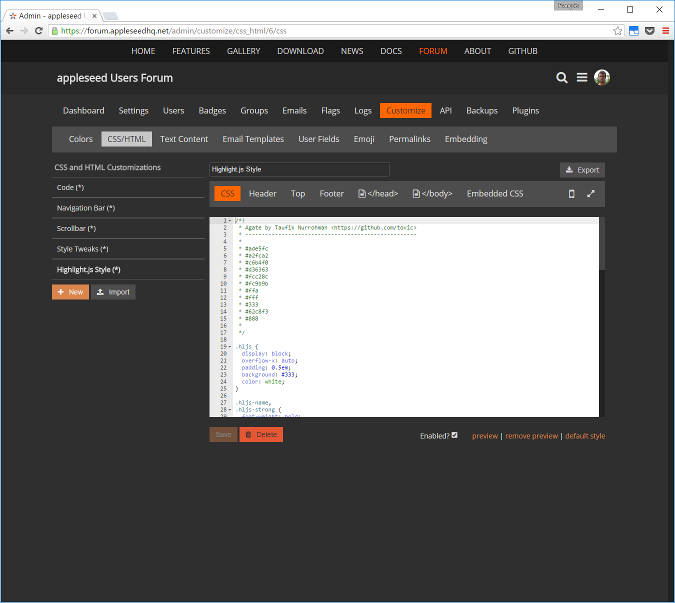

I copy/pasted the CSS from the Agate theme to a new section in Admin / Customize / CSS:

Notice that the .hljs-string color is #f99 which does not match the declared style of this class in the Agate theme:
.hljs-string,
.hljs-bullet {
color: #a2fca2;
Not sure what I’m doing wrong. Any clue?
Looks like I would need to add !important to each CSS property…
Is anyone aware of a better solution?
Edit: it doesn’t look like the !important solution would even work…
Nope, it’s because the default has a higher specificity - .hljs-tag .hljs-string . You need to replicate the theme’s rule with that selector.
