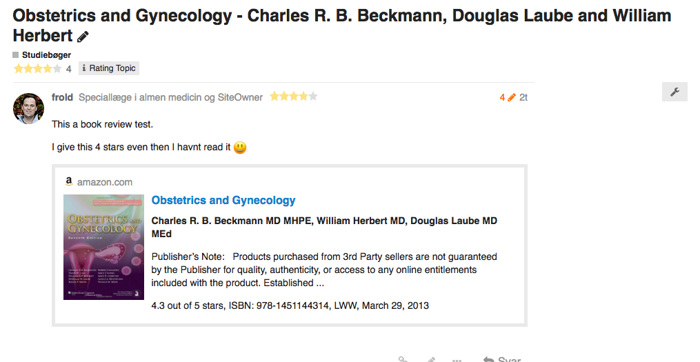

Change max chars in Onebox - enlarge your Onebox?
After Maja did add a more advance OneBox for Amazon links I would like to know if it is possible to “hack” the OneBox to strip more chars so the Onebox gets bigger.
Eg I see the max chars for description is 200 chars. Where can I change that? Then I could have a larger OneBox - or is it not possible to set how large you want your onebox?
I dont see any limit in the onebox/lib/onebox/engine/amazon_onebox.rb at main · discourse/onebox · GitHub so I thought it might be set more globally somewhere…

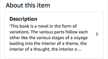

Seems like a dead end?
Ahh, dooh.
It seems like the source that the script rip data from by standart only contains 250 chars
If you eg. go to
https://www.amazon.com/gp/aw/d/0323353177/
And view it as user agent:
Mozilla/5.0 (iPhone; CPU iPhone OS 5_0_1 like Mac OS X) AppleWebKit/534.46 (KHTML, like Gecko) Version/5.1 Mobile/9A405 Safari/7534.48.3
The div with productDescription only contains 250 chars.
If you press the field you go to a new page with the path
https://www.amazon.com/gp/aw/d/0323353177/#productDescription_secondary_view_div_1520843164890
Here you have the full description inside the div productDescription_fullView
It should have a xpath
//*[@id="productDescription_fullView"]
A dirty solution in: onebox/lib/onebox/engine/amazon_onebox.rb at main · discourse/onebox · GitHub
Find the empty line 85 add
      description = raw.at_css('#productDescription_fullView')&.inner_text
Change line 104
        description: raw.at("#productDescription")&.inner_text,
to
        description: description,

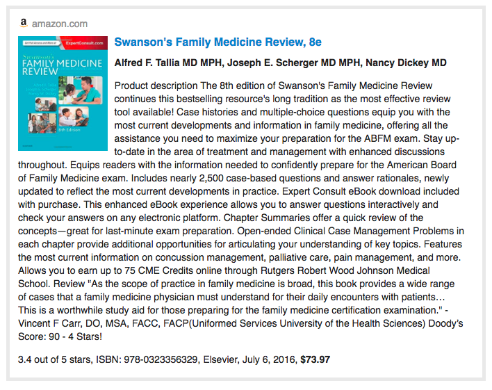

To have something like that
I did add the changes to: Get full details for a printed book by frold · Pull Request #383 · discourse/onebox · GitHub
How to use the changes in my live site?
