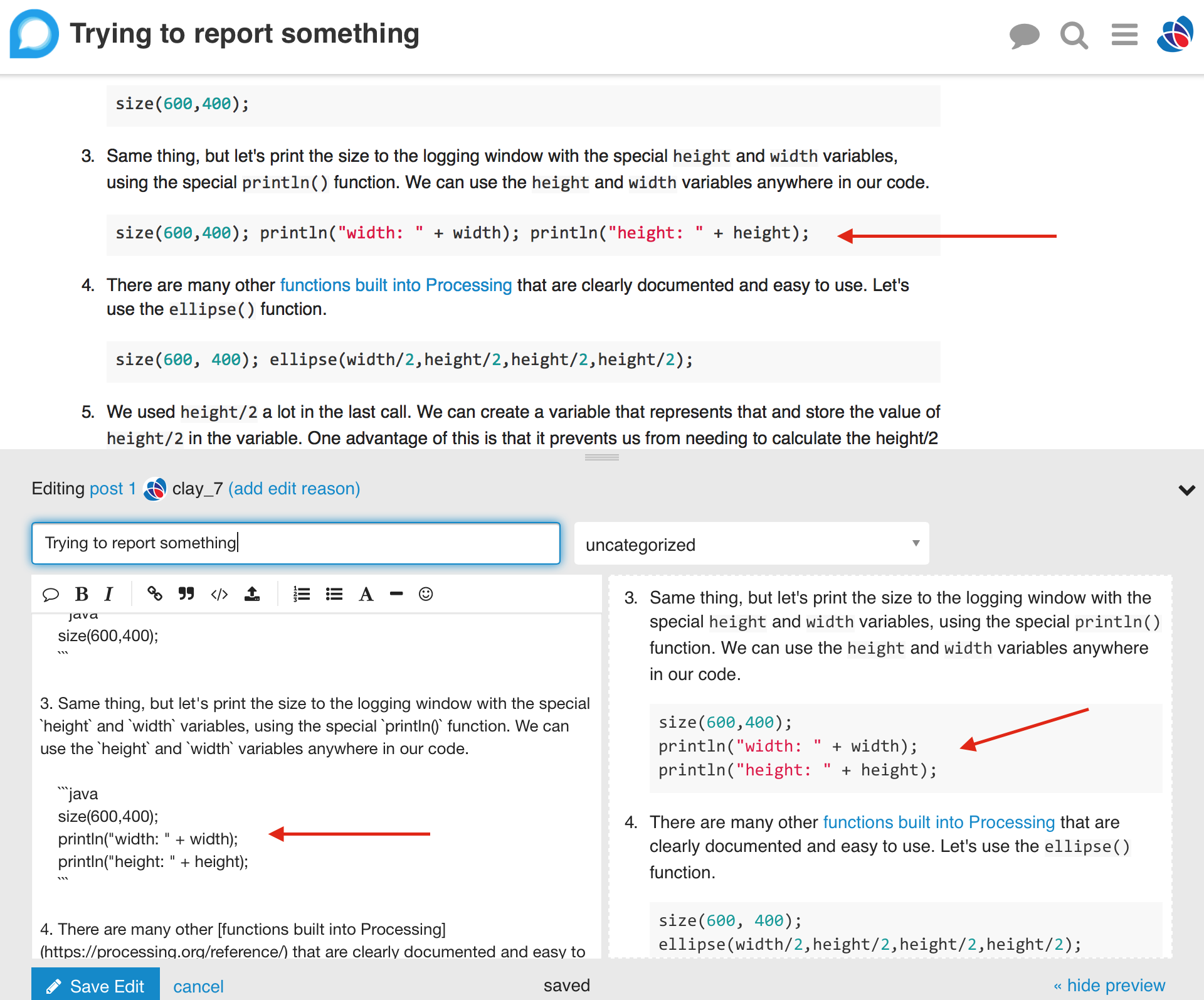

While testing another bug, I posted this text to try.discourse.org:
problem_post.txt (2.5 KB)
The editor preview shows line breaks in the code block, but the post itself renders without the line breaks.

The code seems to work fine when it is not nested under a bullet.
  1. Some list
    size(100,100);
    ellipse(x,y,100,100);
  2. Another list item
versus…
size(100,100);
It’s the backtick code blocks inside list which are not standardized across implementations (the preview and output differing seems like a real bug though). But you can use indented code blocks as a workaround until Discourse switches to markdown-it (which supports what you are trying to do).

Thanks I’ve fixed this in master (it’s currently being deployed):
https://github.com/discourse/discourse/commit/f2db4bfcf3ee6dc024ef1bee91acf66049753501
