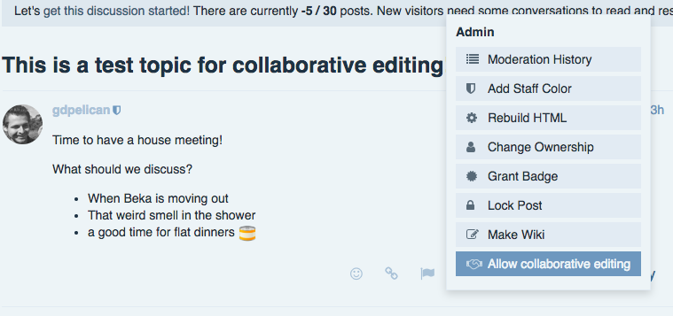

As an admin, create a post, and click ‘Allow collaborative editing’ under the wrench menu
Now, users with sufficient trust level (default is 2, configurable in the settings), will be able to click ‘Collaborate’ and get an editor to modify the post in real time.

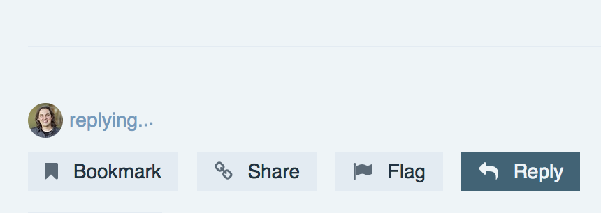

I like the fixes - thank you! I can see this being very useful in my community, especially when we are in one of our many webinars or video conference calls and taking notes collaboratively.
Bummer about not being able to replicate the “replying…” feature. That way we’d know it’s worth jumping in to collaborate, and once in collaborating we’d know who’s collaborating with us.
