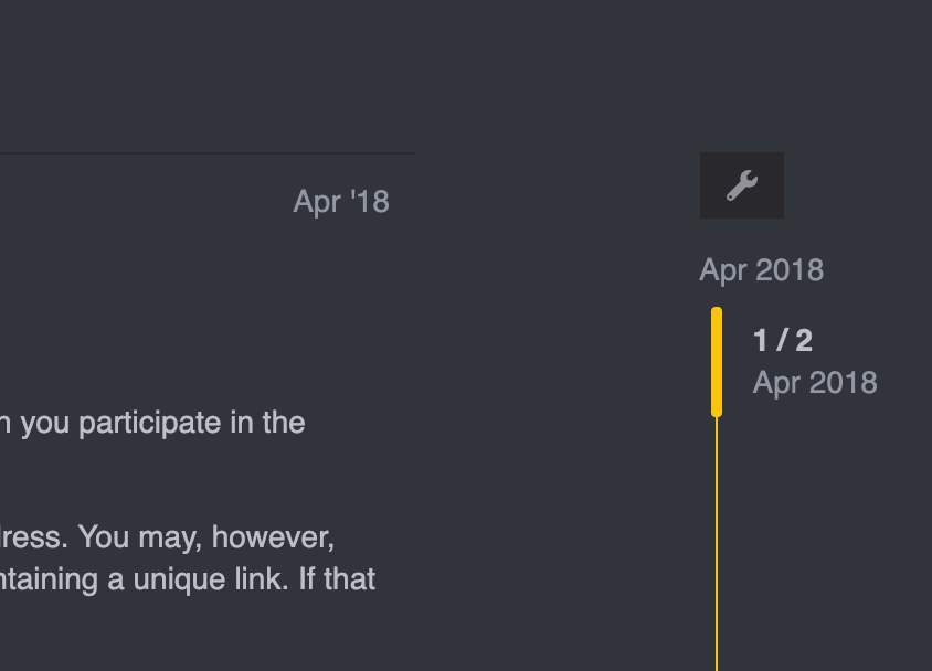

Some of my theme colors have changed after upgrading like the buttons and the quote highlight, etc. Is this a permanent change that I need to tweak via css or a mistake? Seems like a step backwards.
Before:
After:
Edit: I see it was a change made here: https://review.discourse.org/t/better-contrast-ratio-match-between-dark-and-light-themes/933 so, is this expected behavior @awesomerobot?
