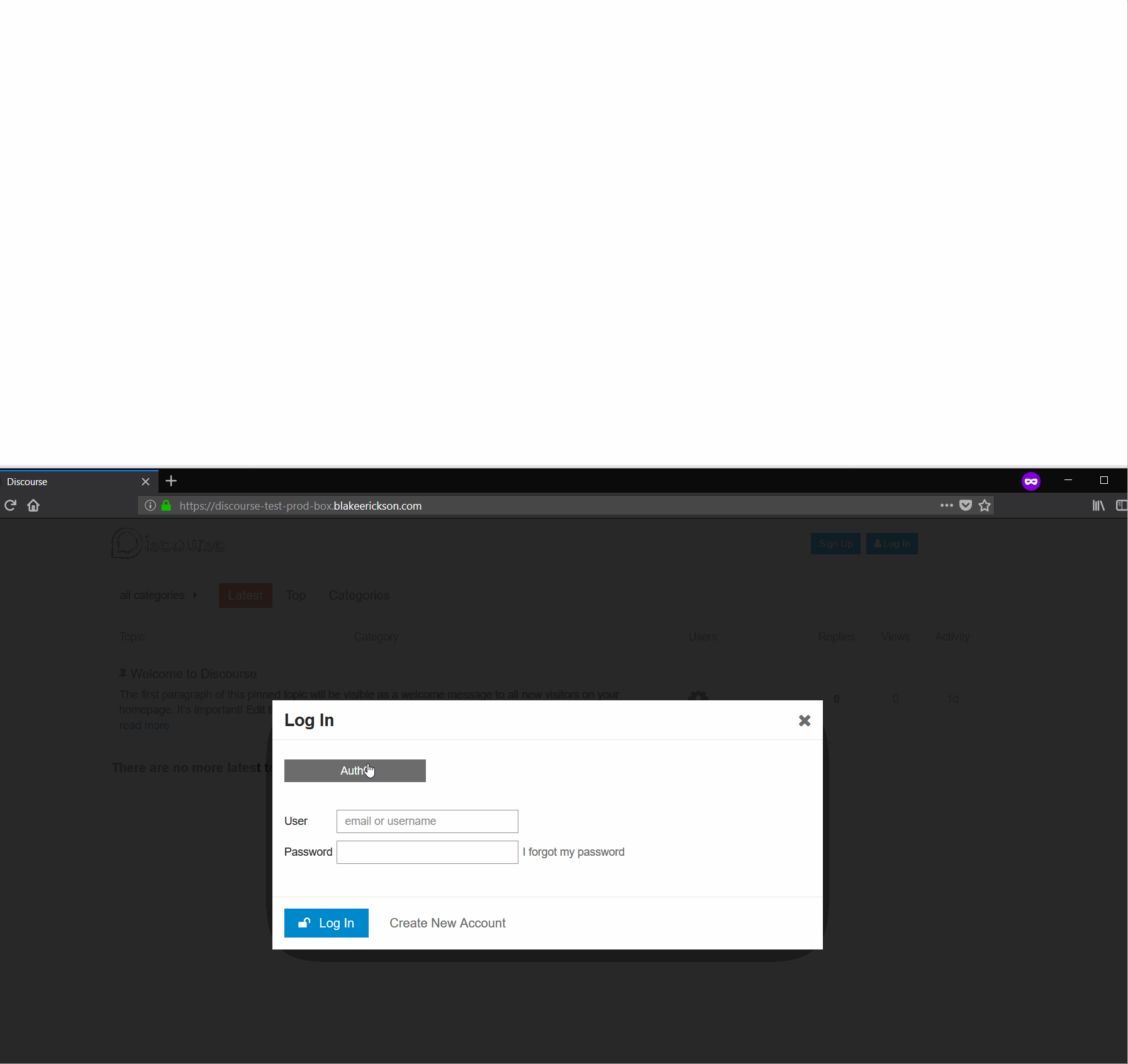

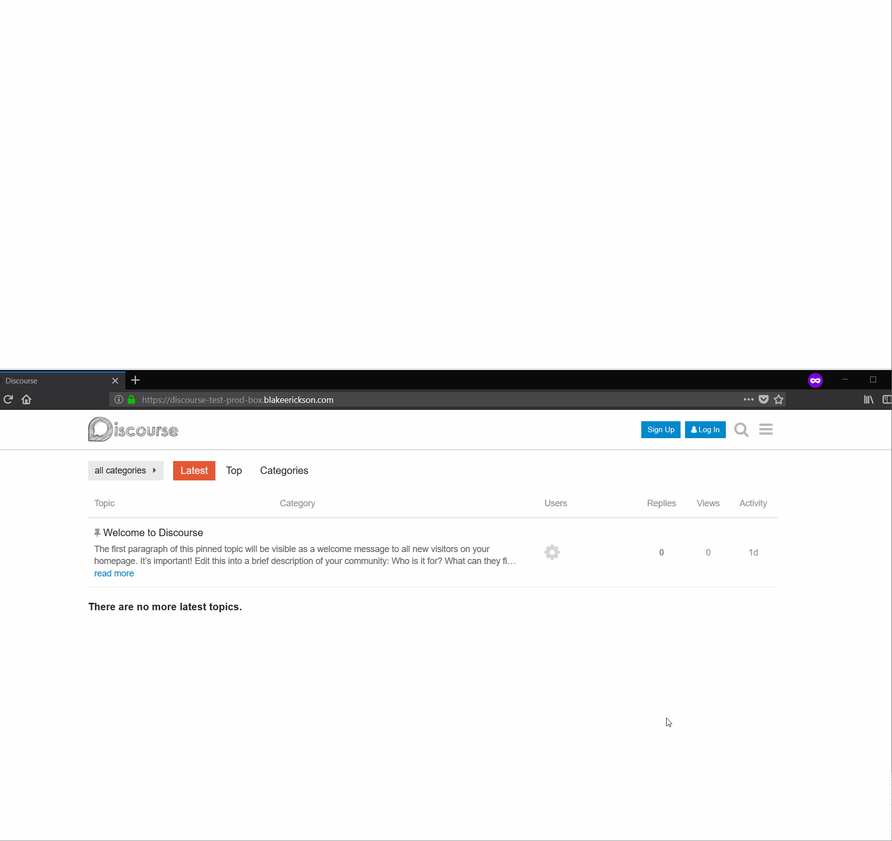

Here is a gif of it in action:

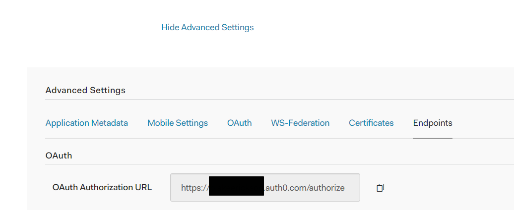

When I attempt to do this, everything appears to work fine until the actual login. When they finish putting all of the information in, they are taken to our forum and are only shown an error message that reads “Sorry, there was an error authorizing your account. Perhaps you did not approve authorization?” with no other options.
The only difference I notice between your instructions and what I have entered is that for authorize url, I am using https://rosen.auth0.com/oauth/authorize as Auth0 instructs instead of https://rosen.auth0.com/authorize, which sends the user to the Discourse signup view rather than the Auth0 app. Am I missing a step?
Side note: I am experiencing this issue with all logins related to Auth0 (social included) but want to just sort out the Auth0 part first, as our social logins work fine through Discourse (with both Discourse and Auth0 URIs input).
Inside of Auth0 if you look at your endpoints it should say just be https://<client>.auth0.com/authorize:
What happens if you change it to just “/authorize” and remove the “oauth” part?

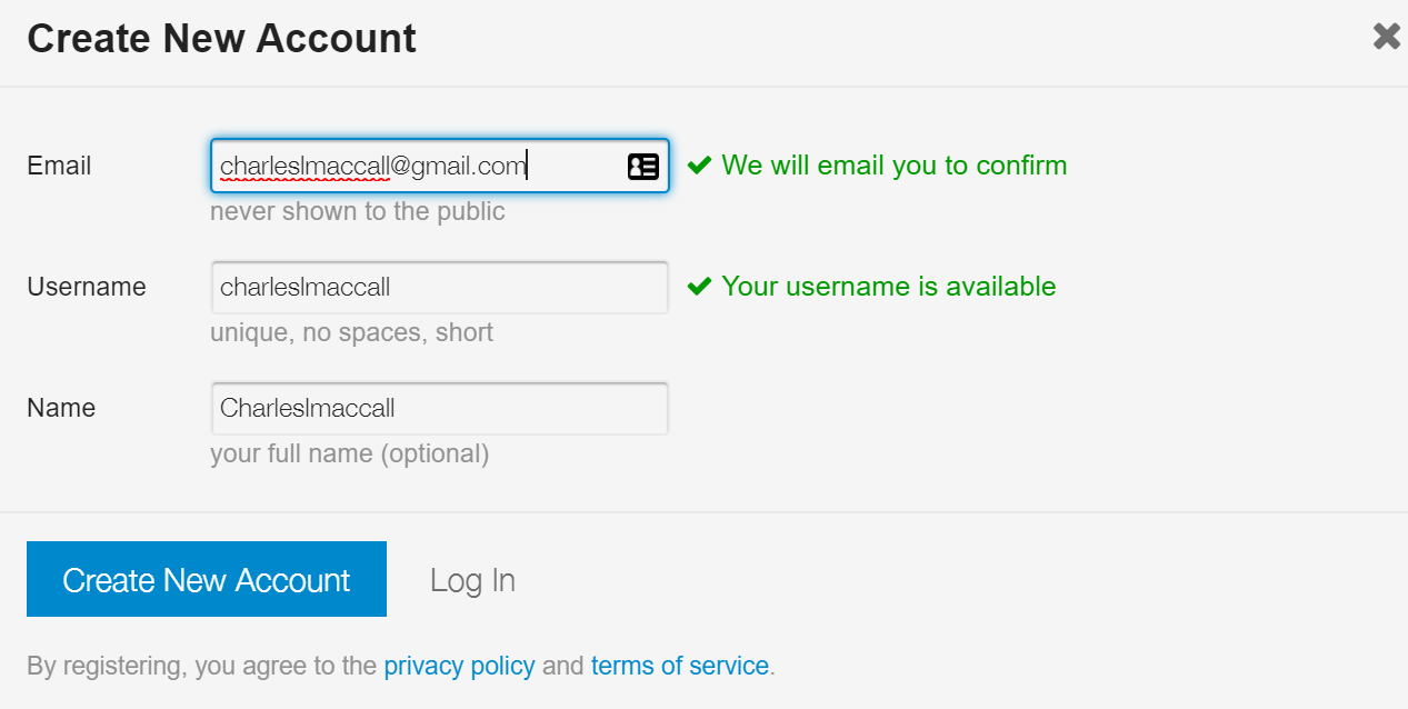

Ahh, perhaps I was mistaken by what would occur. Once I do that, it auto fills the Discourse account registration with the e-mail of my Auth0 account. Is this what should happen? I thought it was just using my Auth0 e-mail address to create a Discourse account rather than logging me in using Auth0. When I do it with oauth/authorize, it pops up an Auth0 box that let’s me enter in my Auth0 credentials there. Below is what I see when I click the button using https://<client>.auth0.com/authorize
In your Discourse site settings there also is a checkbox for “oauth2 email verified” that you can check, and then the user doesn’t have to enter in an email.

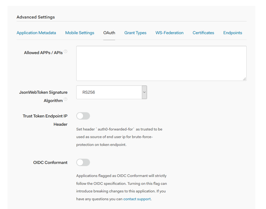

This means something somewhere isn’t configured correctly, my first guess is in the auth0 dashboard somewhere. Can you tell me what your settings are for your application under “Advanced Settings” → “OAuth”?
I think you may need to turn off “OIDC Conformant”.

When a user clicks to sign up using the Auth0 (set up as the OAuth2 method) account, and authenticate or create an account, they are dropped back to the Discourse ‘create account’ form - and a user is created successfully in Auth0. The password field is hidden on the create account form, but no other fields are pre-populated.
I’d expect that the fields such as email and name would be pre-populated as the user in Auth0 has these fields available.

Can you to into your Auth0 application settings and then “Advanced Settings” → “OAuth” and turn off “OIDC Conformant” and see if that helps?
