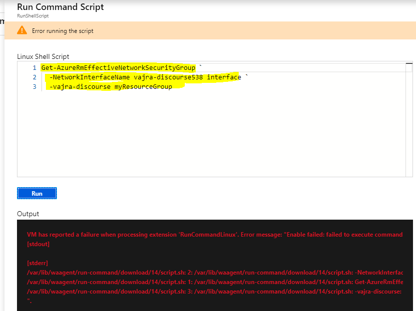

Setup Discourse on Azure I follow these step when i create tej swap I facewhen i the issue
create the [SwapFaq - Community Help Wiki]
Any ideas on this @blake?
I don’t know where the command Get-AzureRmEffectiveNetworkSecurityGroup came from, but you don’t need the instructions in the SwapFaq link to setup swap, you should follow the swap instructions in Setup Discourse on Azure.

Above you are using “Run Command Script”. This won’t work. You will either need ssh access into the machine or you can use the Azure Serial Console from the Azure Portal. You can find the Serial Console by clicking on your VM in the azure portal and it will show up in the left pane at the bottom:
