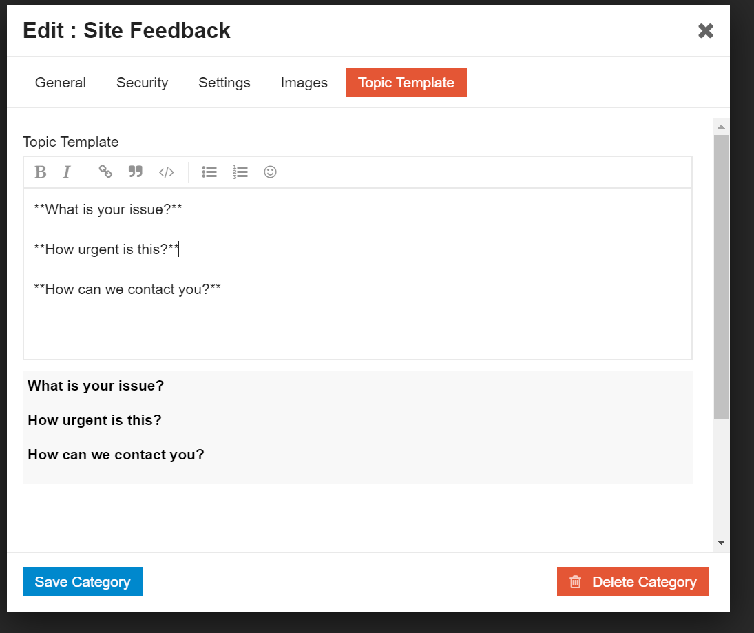

I’m looking at the following theme as a reference.
My goal is to find a way to put up a secondary new topic button that shows up for members of a specific group. This group has access to a private area in the forum and I’d like to be able to have the button in question start a new topic in that area of the forum regardless of their current page. I’m also looking to use a topic template or similar boilerplate functionality with this button. I think I’ve figured out how to selectively add the button based off the primary group class on the body, but I’m not quite familiar enough at the moment to insert some boilerplate text(or topic template) into new topics started with this secondary button. Anyone have any pointers?
This is possible. You need to first prep your category with a topic template. Go the category you want to use and edit its topic template like so:

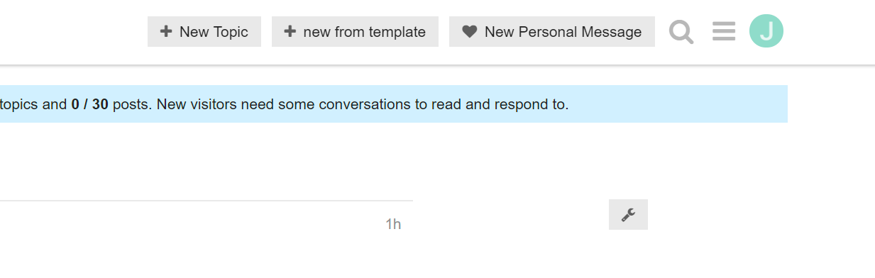

What this will do is add a button to the header like so:
Clicking the button will open the composer and the fields will be pre-filled with whatever you chose:
